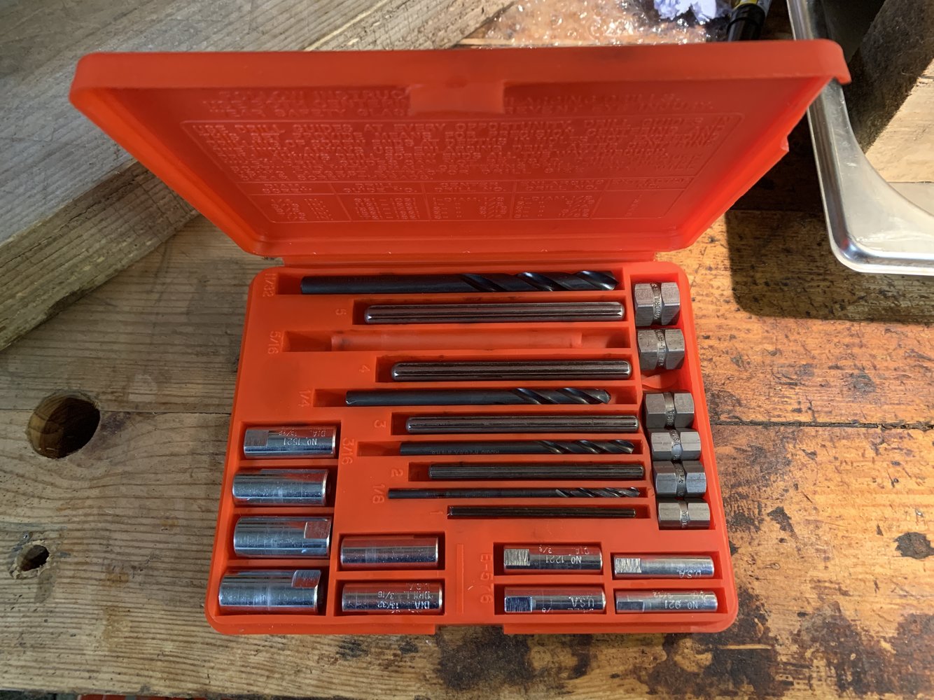

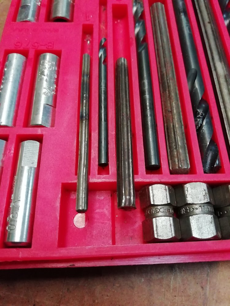

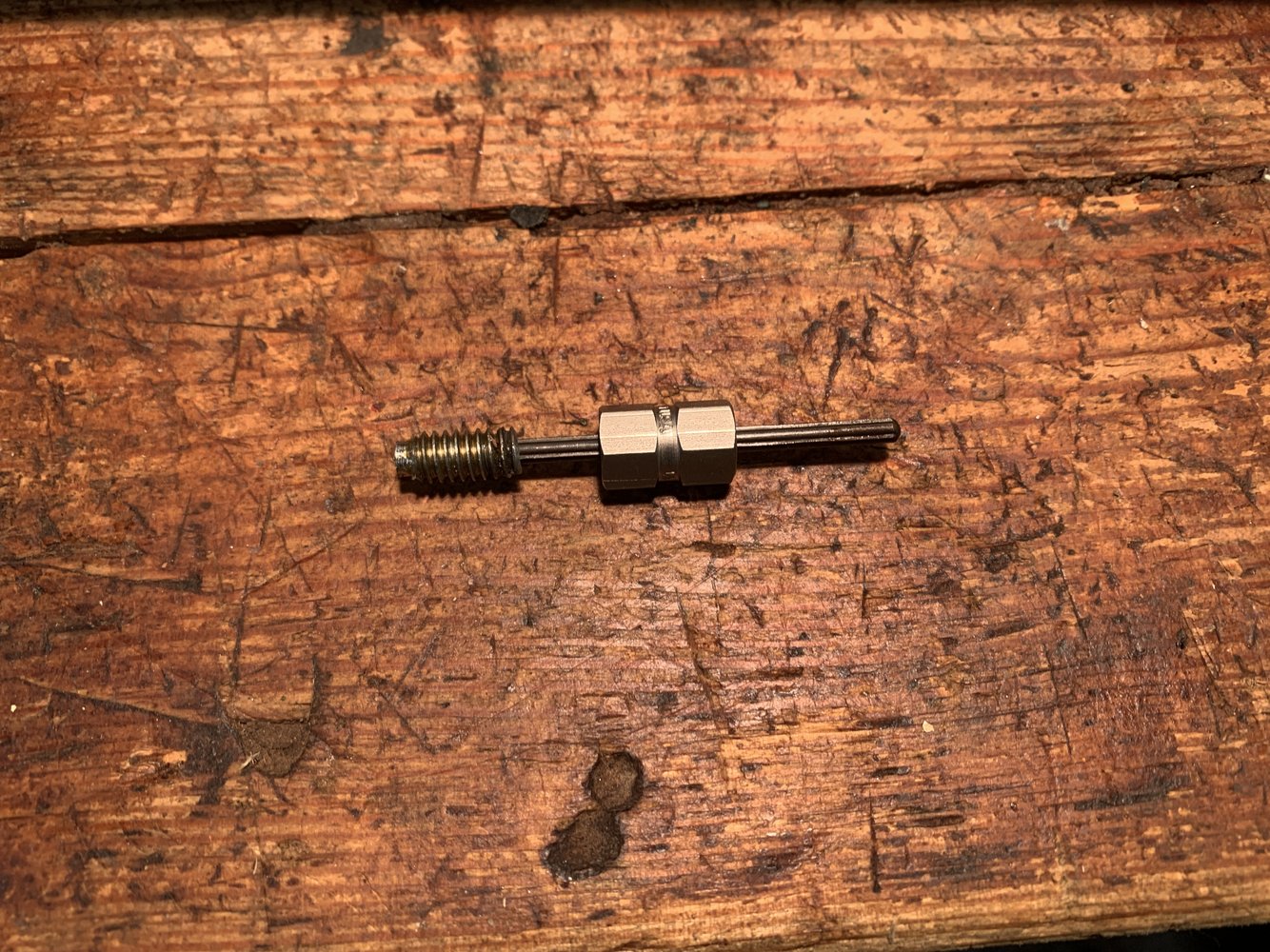

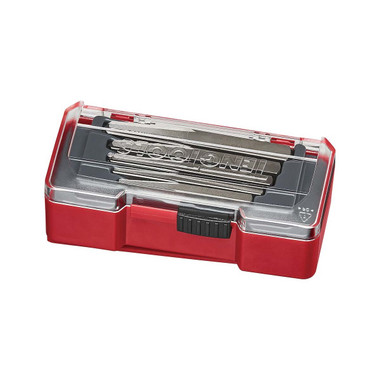

I think these are different tools, the ones @Keithmac is talking about are specifically for removing knackered allen/hex head screws/boltsThese are the old type

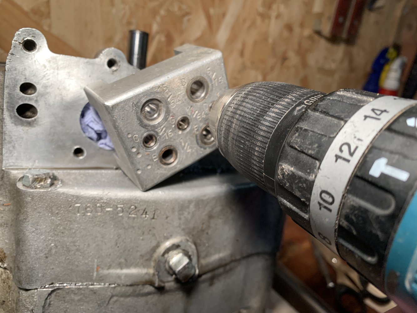

There’s a set of 5. The only thing that is better than the new ones is you beat these in then wind them out with a 12 point socket. The harder you pull the more they bite. They have never lost.
As with the other set, and the new ones (I imagine), 99% of the success is in the correct pilot drill

They’re available … unfortunatelyI am going to get a set.
I have the older ones like a twisted square bar, but yours are better.
Left hand drill bits are a good thing with any extractor
I’ve slowly been replacing all the hex countersinks with torx on my kids rc cars. Usually drill the head off then wind the stud out but those look like just the job.
Sounds interesting. I’ve not yet had a torx that I couldn’t get out but never say never. … please don’t post the part number !They also do a set specifically for damaged Torx, the annoying thing is when they were first on the van they were about £70 I think. I had fully planned to get both sets but was too late.
