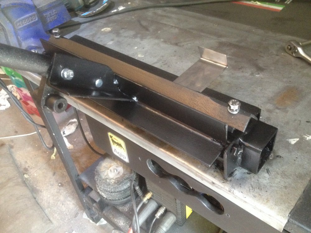

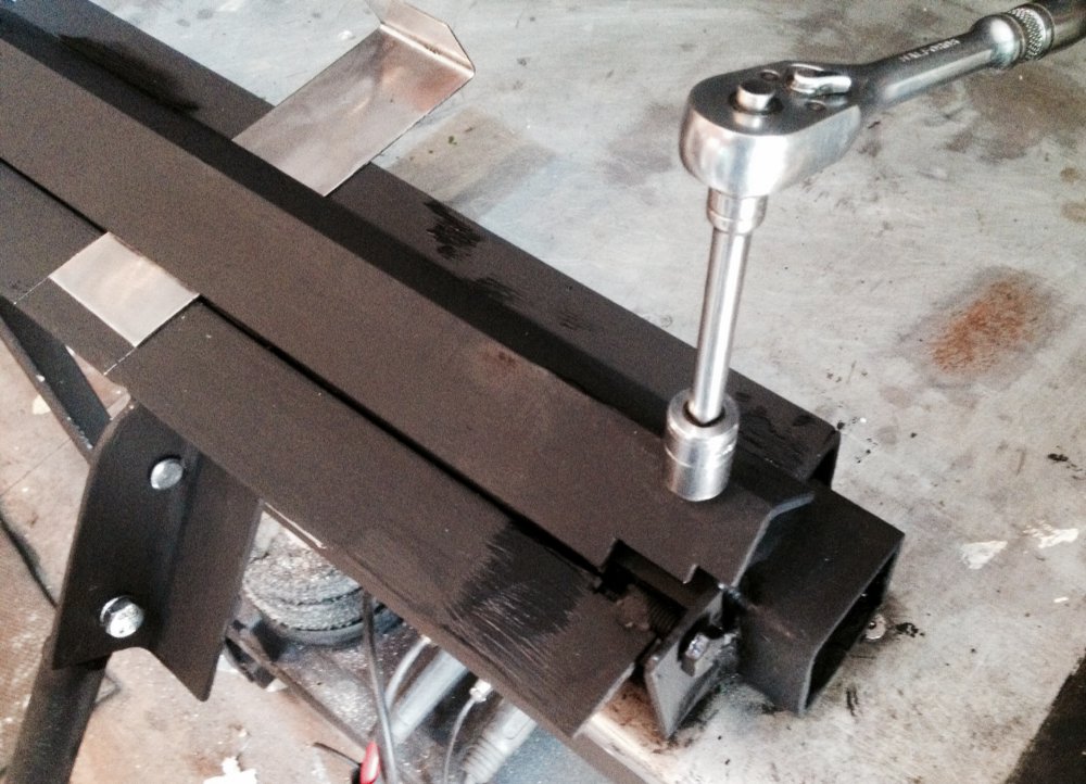

This is my bench mounted sheet metal bending project..
I've made mine to fit on my bench with a detachable handle.. Works a treat with nice tight angles.. The clamp has release springs fitted below..

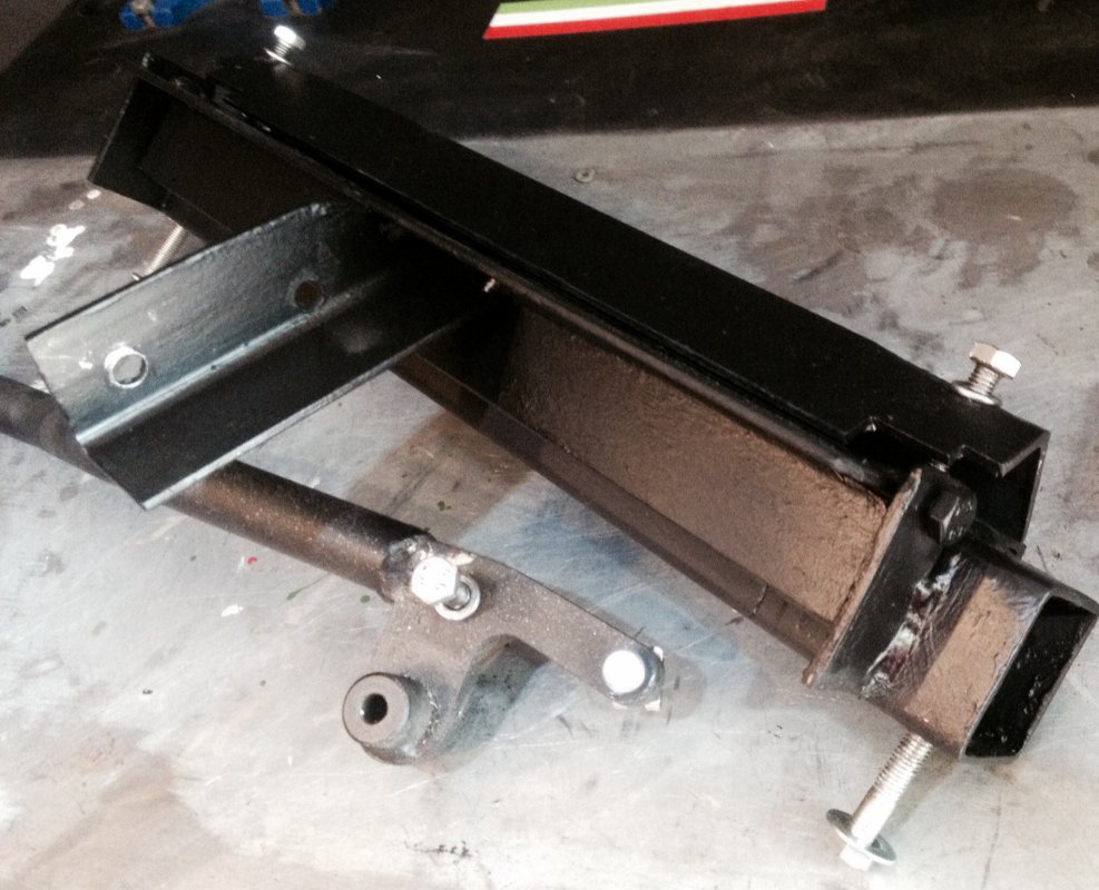

Handle detached..
Bench mounted via threads in base..

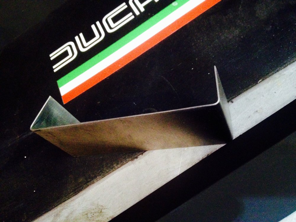

Stainless sample

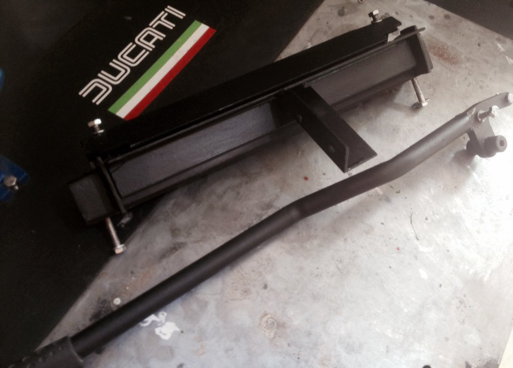

Handle detached..
On the bend...

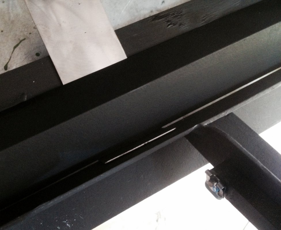

Tightening the clamp

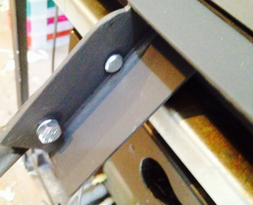

Handle mount..
