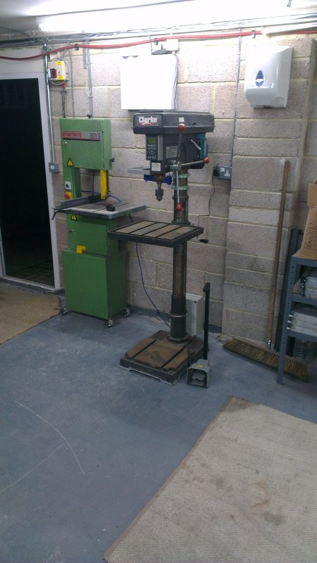

Until I got hold of the tapping head, I got by just starting them in the drill press winding it round by hand, then finishing the job with the part in a vice by hand. Moly grease is your friend. Or trefoil, or tap magic or whatever brand of moly based grease you want to use.
