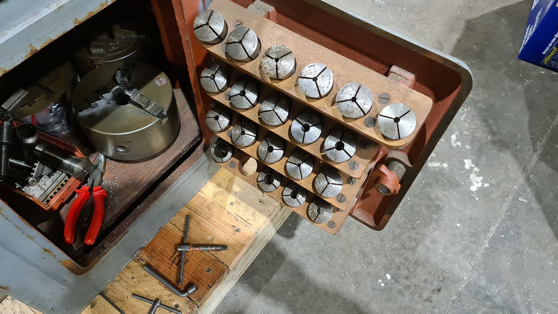

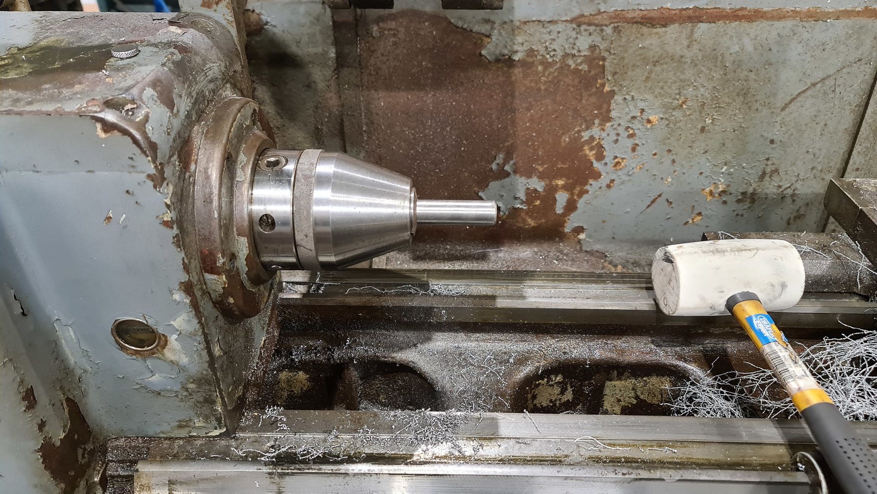

Very similar to what I had with my smart and browns except they fitted straight in the spindleThe one that came with my CVA. So simple why aren't they all like this?
Just a drawbar with a handwheel. Takes 5C collets. Not only did the lathe come with a full set but I have loads more including square and hex.
