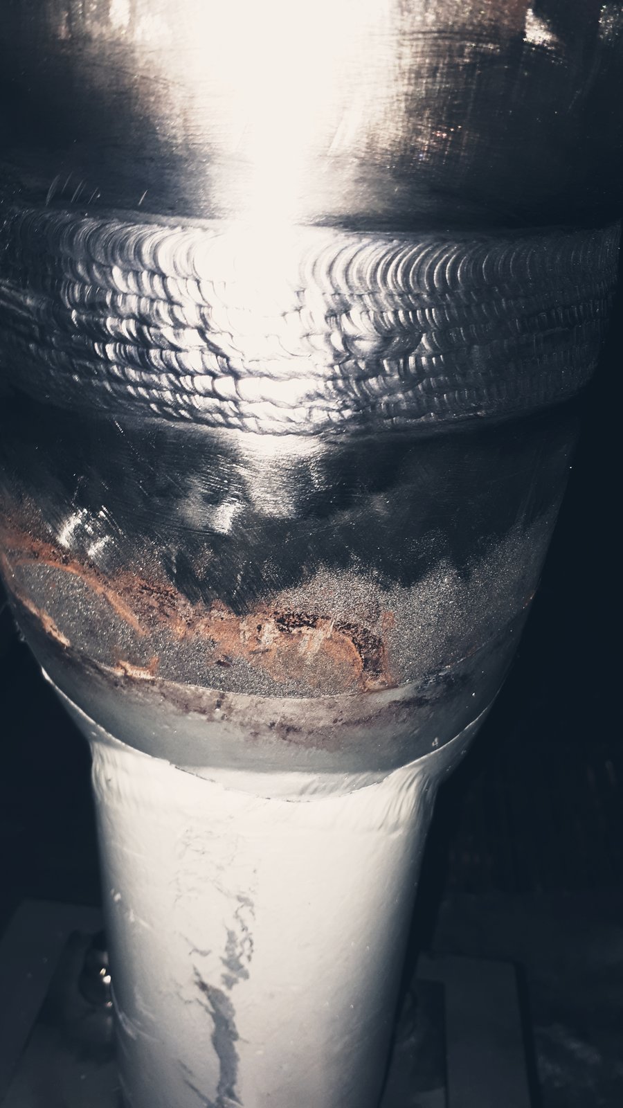

been welding this for about 12hrs in total
its normaly tig root and a couple of passss then fillled and capped with flux core mig
the mig monkeys were all on leave so was asked to use the tig procedure .amps were root 145 hot pass 175 fill 225 and cap at 210 amps its 6 inch bore with 40mm wt
all jammed in under a scaffold of course.
and plenty of decaying fire blanket that gets everywhere and make you itch like hell
Do you still want to be a welder ?????
