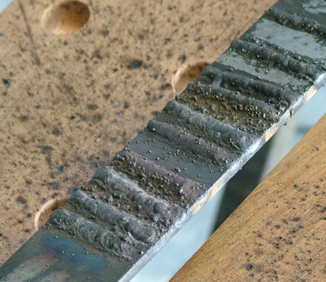

Hi, Well I'm new to MIG welding, having bought a cheap gasless setup last week. I have been reading the board for a few weeks now and just want to say a big thanks to all the posters so far. I have learnt heaps and can actually now run a bead with the MIG thanks to a lot of the posts here.
Why gasless? Well I have a stick welder for heavy tasks, which gets used about twice a year at most. I cant weld thin stuff with it as it is simply too powerful (plus I'm a poor welder lol). I wanted something that would weld 1 to 2mm steel, but also be economical to use just every few months (i.e. no gas bottle rental), plus cheap to buy (So Mrs Horrorking would allow it)
I understand the limitations of the machine, accept the cleanup needed (darn they sure DO spatter!), and am rather happy with the purchace. All I need to do now is get an auto darkening helmet, another roll of wire, as I have used 1/2 a 450g roll already, & I'll be set.
My main welding will be for stuff for my christmas lights - frames for displays, mini-trees ets, so the MIG is well suited to the low-volume and low-current welding I'll need. Once I got the feed rate right, I can actually get a bead that looks horrible, rather than "Oh God, did you let your dog weld that?" which was what was happening to start with. Now all I have to do is practice, practice, get leather shoes as slag/molten sparks BURN!!!!, and practice.
Edit: Oh and I just fixed the poor weld look. I read in a post about poor welds because of an uneven wire feed. Well the Ozito came with 2 feed rollers - installed was a knurled roller with no groves, so I swapped it for the groved roller, and reduced the tension on the clamp on the wire feed to almost nil - darn, I CAN WELD!!!!
Honestly, it made all the diffference in the world to the finished weld. The weld sounds "more powerful" when welding, its a nice even crackling sound while welding, and I actually managed to wind the wire feed speed back about 20% to get it even better, and there is no "burn back" of the wire as there was before at the same speed. Low current welds were hard to do - now they are easy. Darn, it was all so simple.
