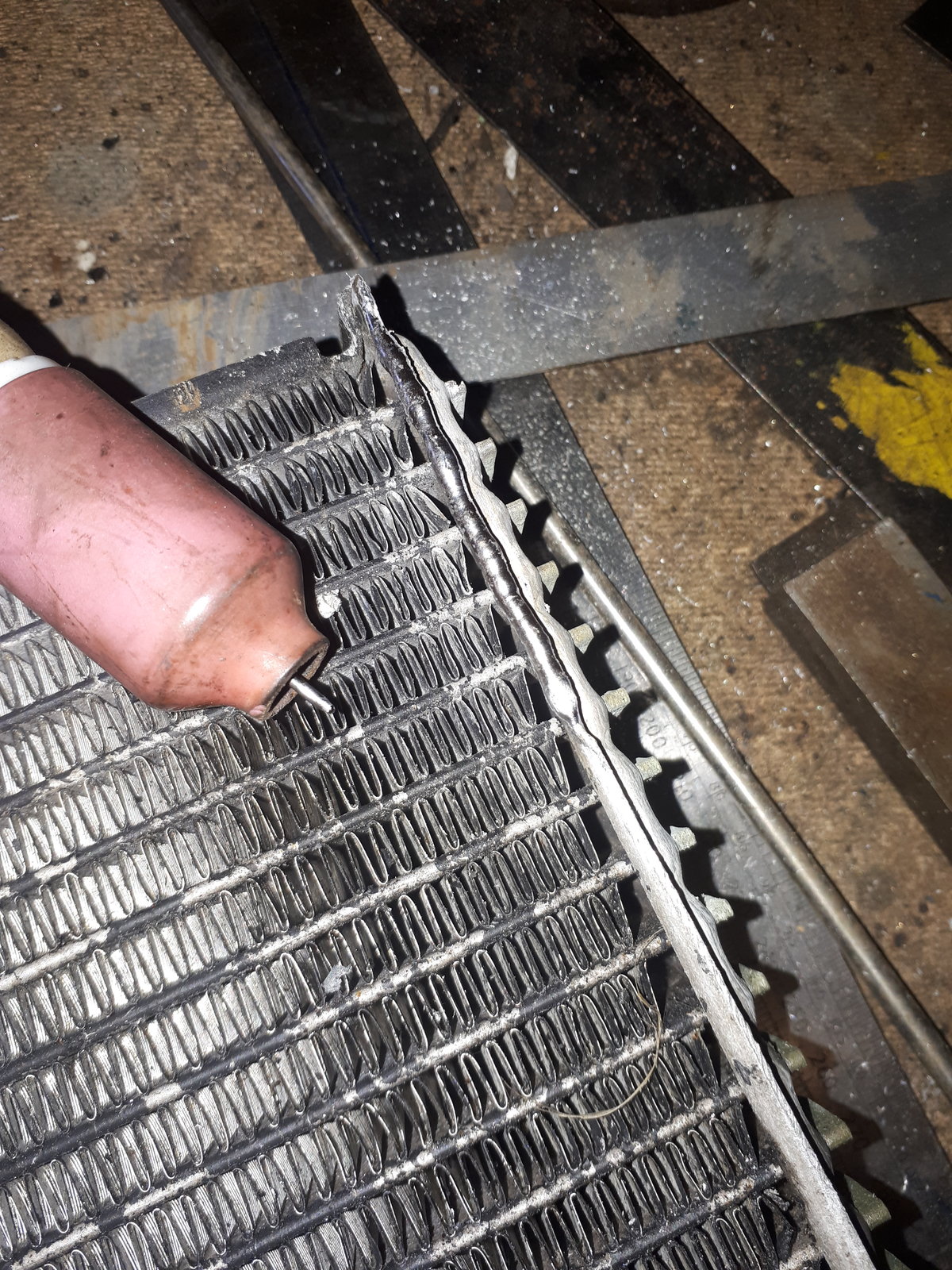

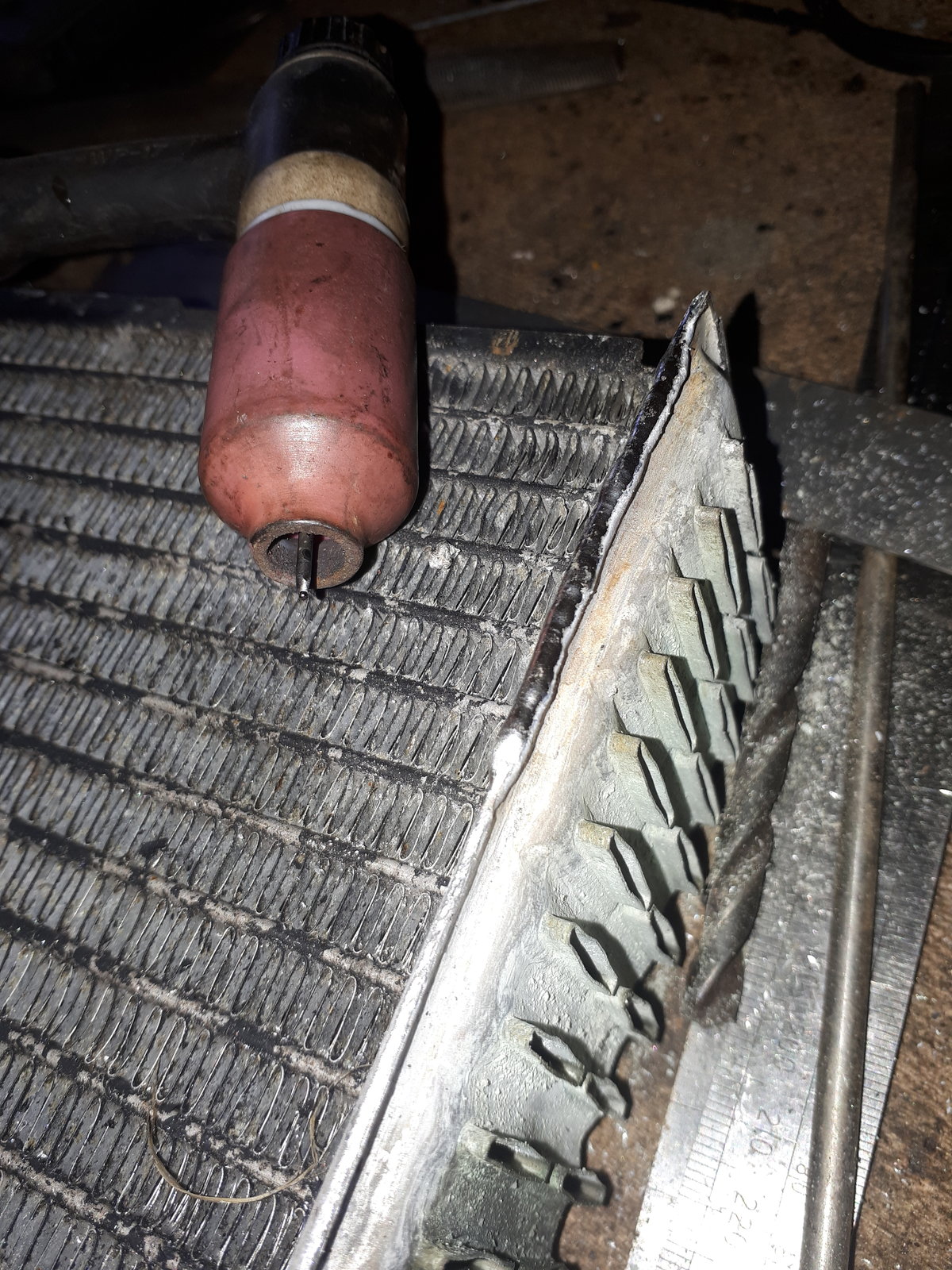

this morning i cut the plastic tanks off an old Audi radiator just to see if its feasible to weld on aluminium tanks and connections for my conversion
it seems to be fairly welder friendly material and took 5356 1.2 mig wire with no fuss so il get a new unit and mod it
