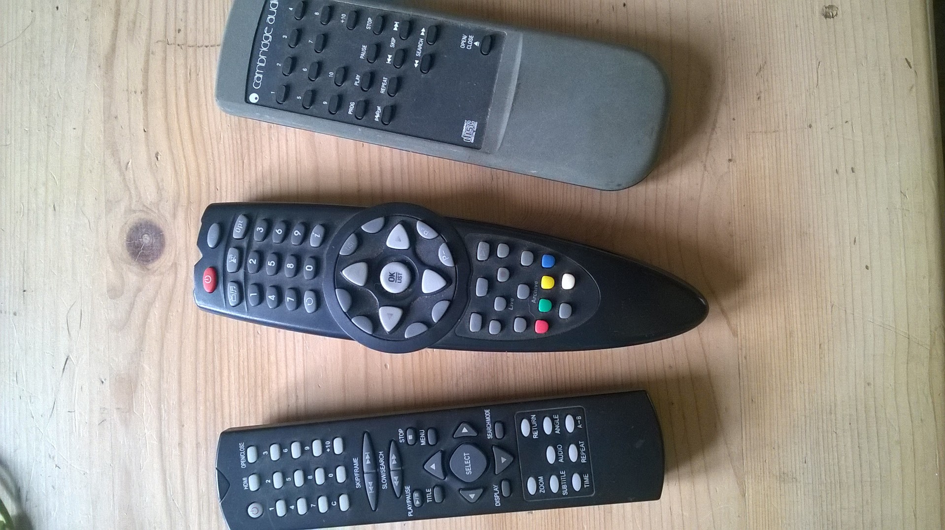

What you'll need to test your helmet is a remote control. It doesn't matter if it's from your TV, VCR, HiFi or anything else. All it needs to do is produce an IR signal.
Any of these will do
Set up your mask how you'd like and then look through it as usual. Aim the remote control at your face and press a few buttons. Your mask should go into its dark state and stay there whilst you hold a button down. If you get nothing at all then try increasing the mask's sensitivity as high as it will go. If you still get no joy then you should test the remote control is working - see the next section.
It's worth mentioning that remote controls don't send a constant stream of IR. It's a pulsed signal so if the remote control's pulses are slow and your mask's delay is set very low then you /might/ get flickering as the mask jumps in and out of its dark state. If this happens then try turning the delay up and re-test.

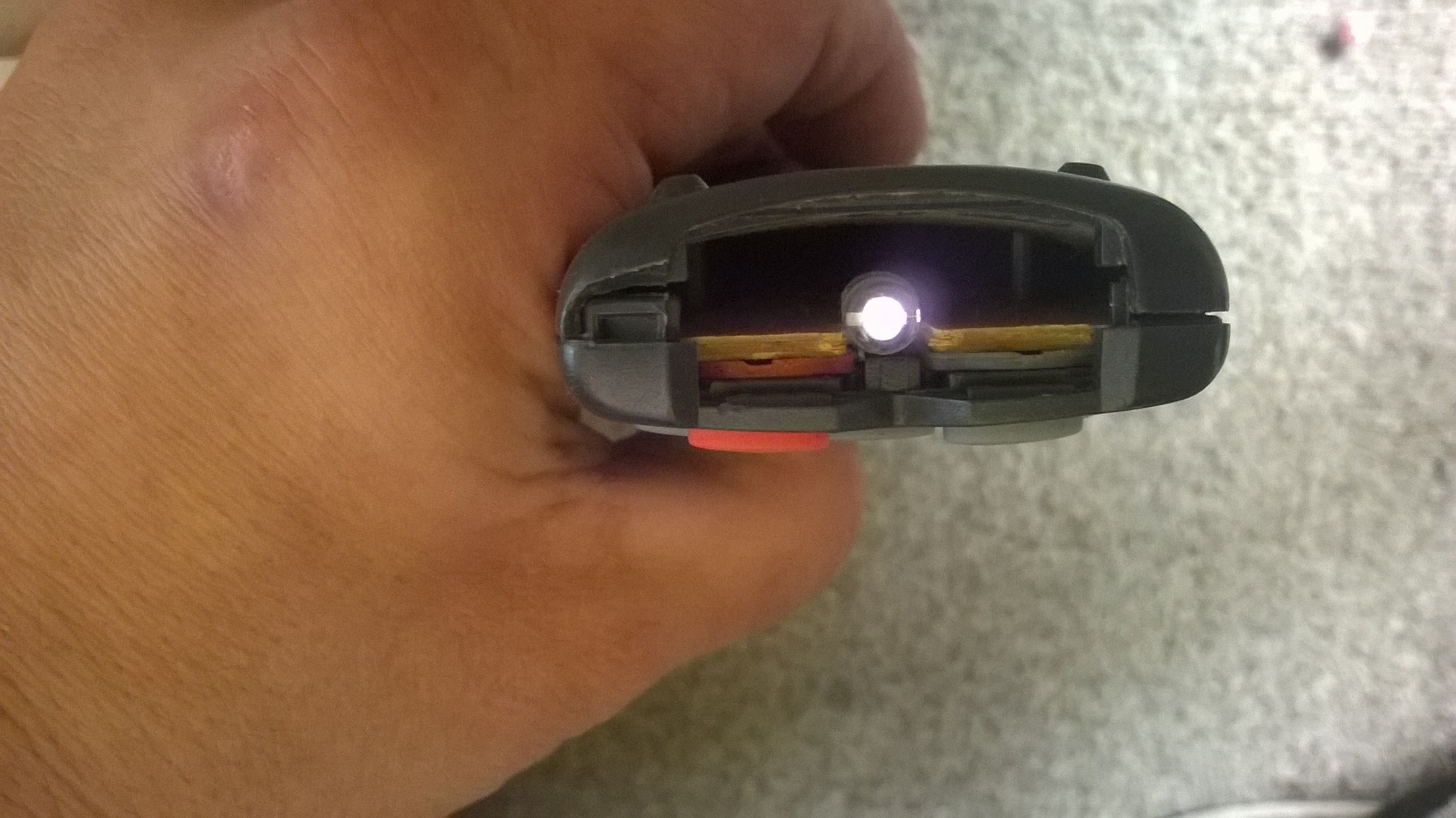

You can test that the remote control is actually working by aiming it at a digital camera when you're looking through the camera's screen (the optical viewfinder won't work). The IR from the remote control makes a pinky/purple light on the screen. That way you know it's working.
Don't look too long or you'll end up in another dimension!
