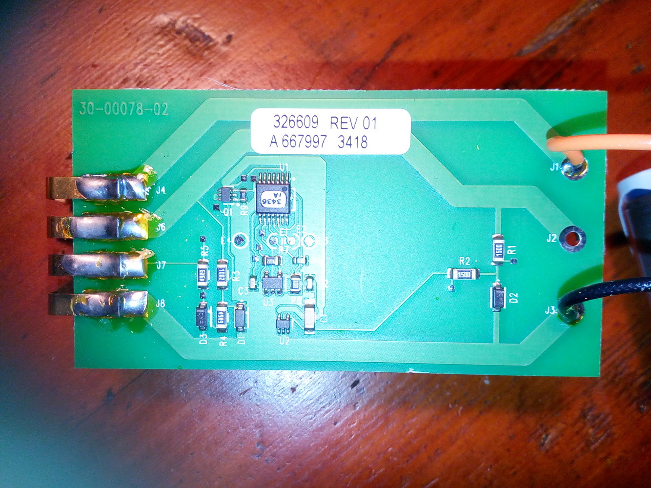

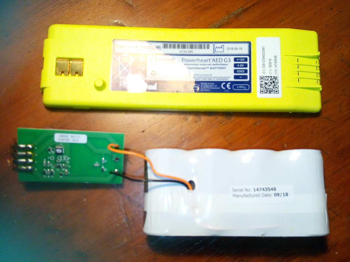

Is anyone out there familiar with testing the operation of AED batteries?
I am a voluntary community first responder and one of my duties is to look after our local public access defibrillators (AED). All of our AEDs are Cardiac Science model G3 and are now quite obsolete so replacement batteries are horrendously expensive and due to their age, are now starting to fail. Our local ambulance service provide all of the AED consumables but are reliant upon old stock and recycled parts so it's frustrating when we replace failed batteries with batteries that have only been self tested.
The AED batteries are Lithium Sulphur Dioxide (LiSO2) and have two output Voltages, +12V & +5V. Upon measuring the outputs I recorded 11.74 Volt at the +12V terminal & 0.0 Volt at the +5V terminal.
I know that the battery is monitored and wondered if I should be getting 5 Volt at the +5V terminal when the battery is removed from the AED body?
Any thoughts?
