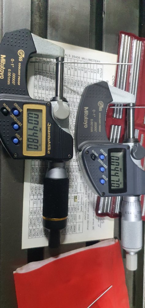

I had posted a post regarding a suspect M14 1.5 pitch thread
With everything's help, it was determined the thread was out off minimum specs
Well, I am looking to put a email together and before I do, I need to ensure my measurements and calculations are correct
This leads me to my new question.
My thread pins say to use 0.040 thread pins and to use a constant of 1.7490 to do the calculations
Only when I measure my 0.040 pins I get 0.044
How do I factor in the error of my pins being slightly over sized
