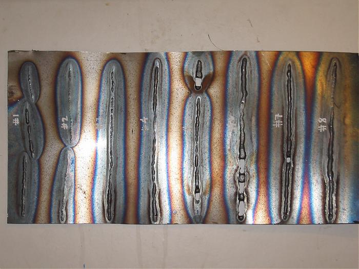

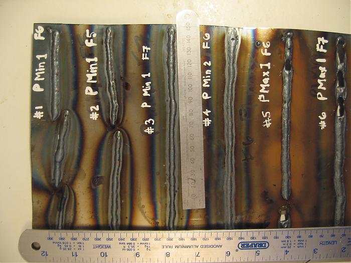

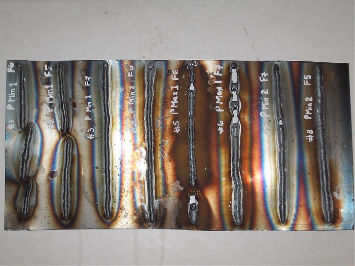

I've just done some test welds and would welcome your comments.
Clarke 135TE,
0.6mm wire,
universal argon mix,
18 gauge / 1.2mm mild steel.

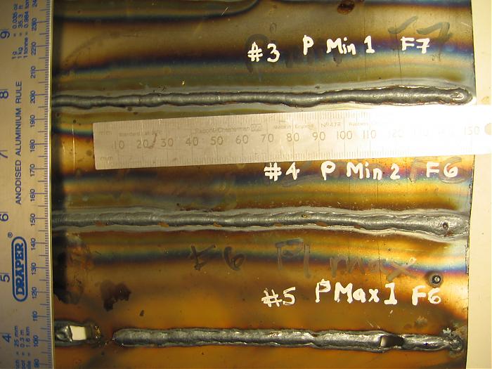

#1 & #2 not quiet enough penetration

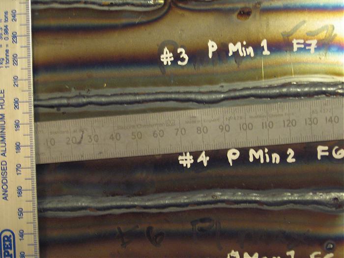

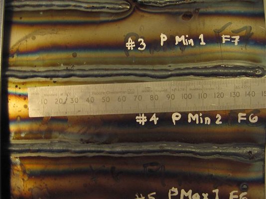

#3 & #4 have good penetration but #4 is a little flatter.
#5 & #6 too much power
The lowest power setting & feed rate F6 seems about right. With a bit of practice I might be able to use the next higher power setting - but I don't know if it would help.
Your comments please.
Cheers
C.T.
