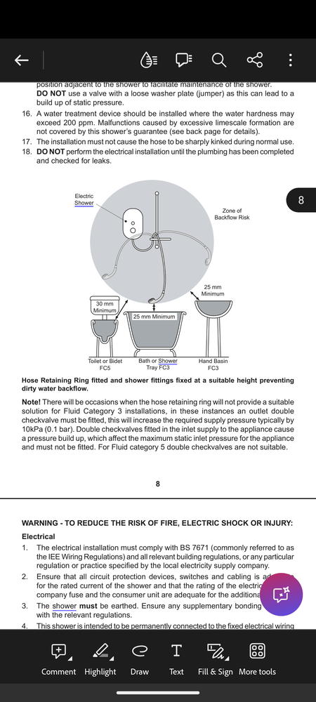

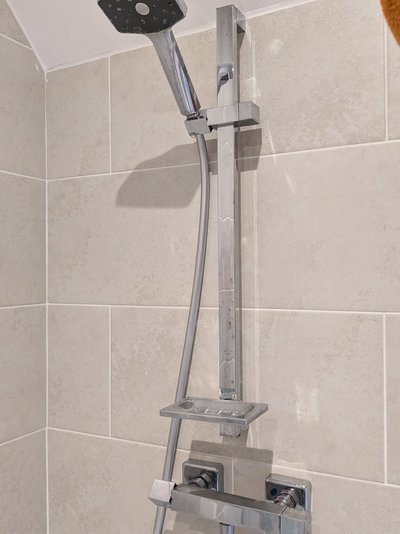

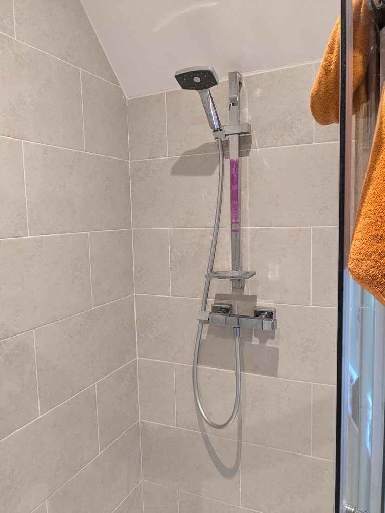

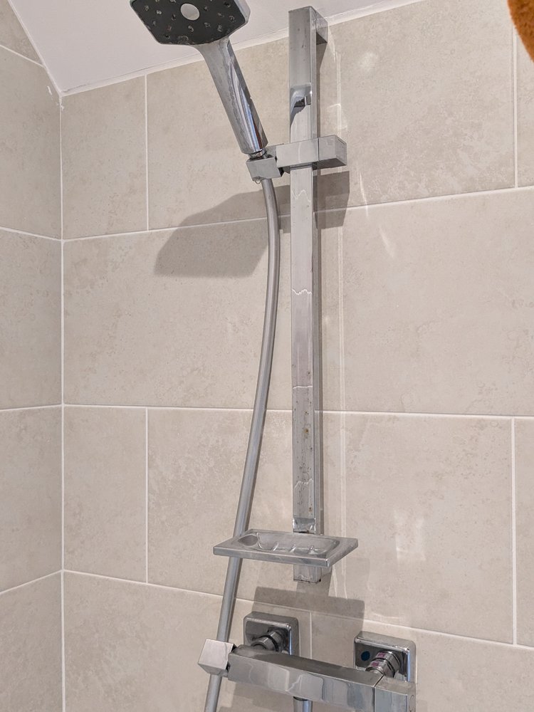

You need a mains water feed for an electric shower. I would have thought your cold feed on your mixer will be from the cold water tank in the loft and will not have enough pressure for the elec shower, unless you have a pressurised hot water tank or a combi boiler feeding the mixer.
