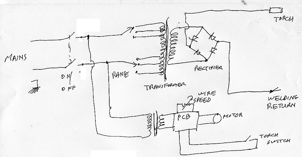

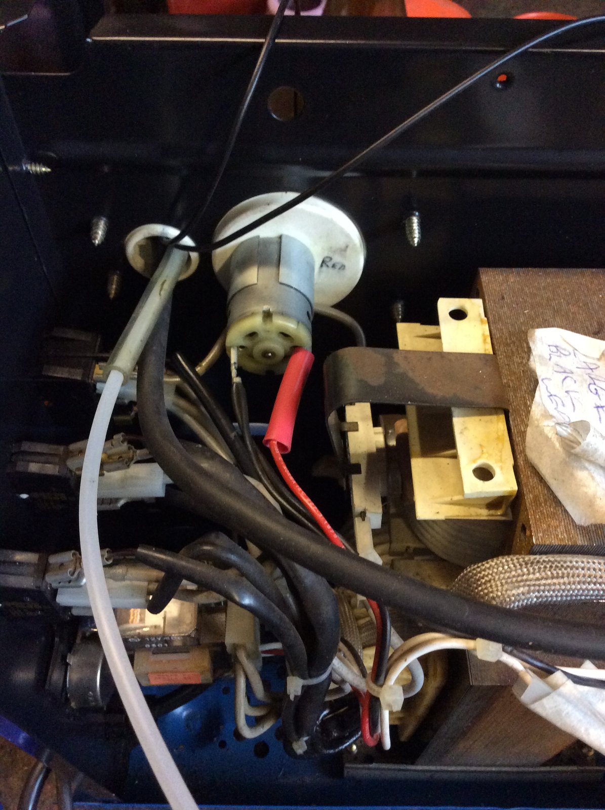

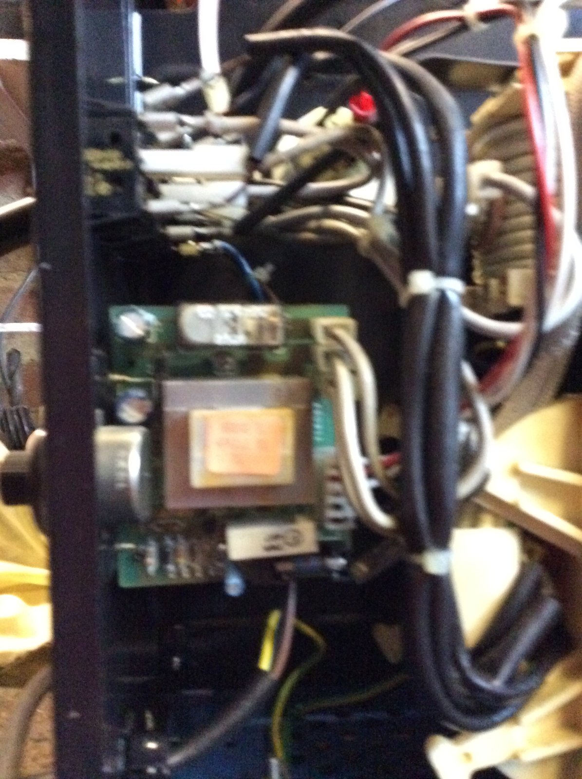

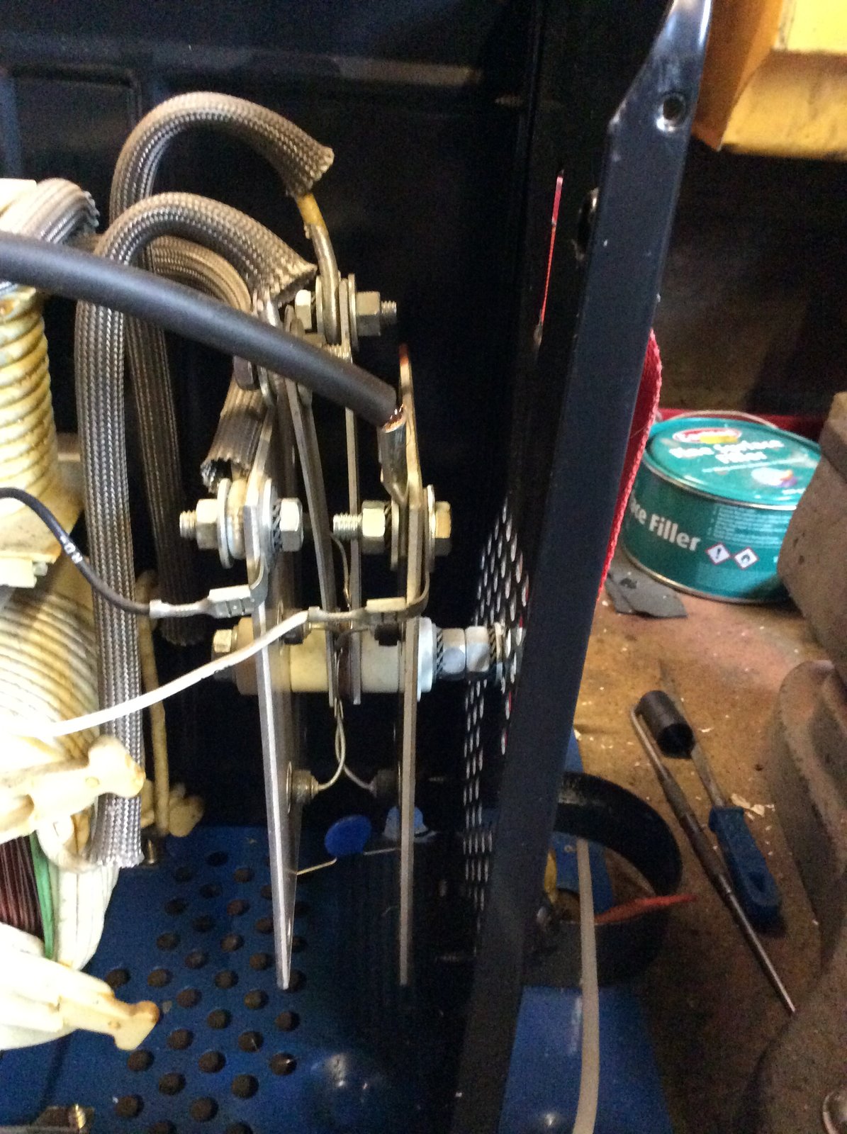

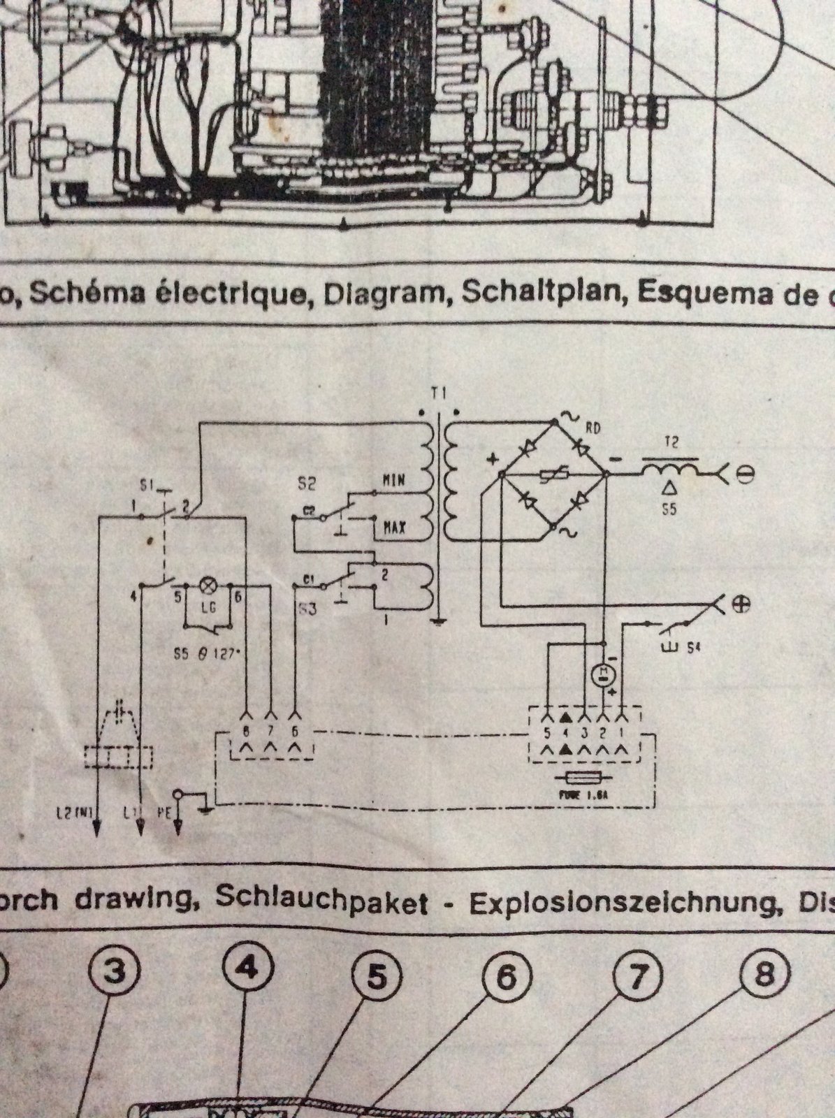

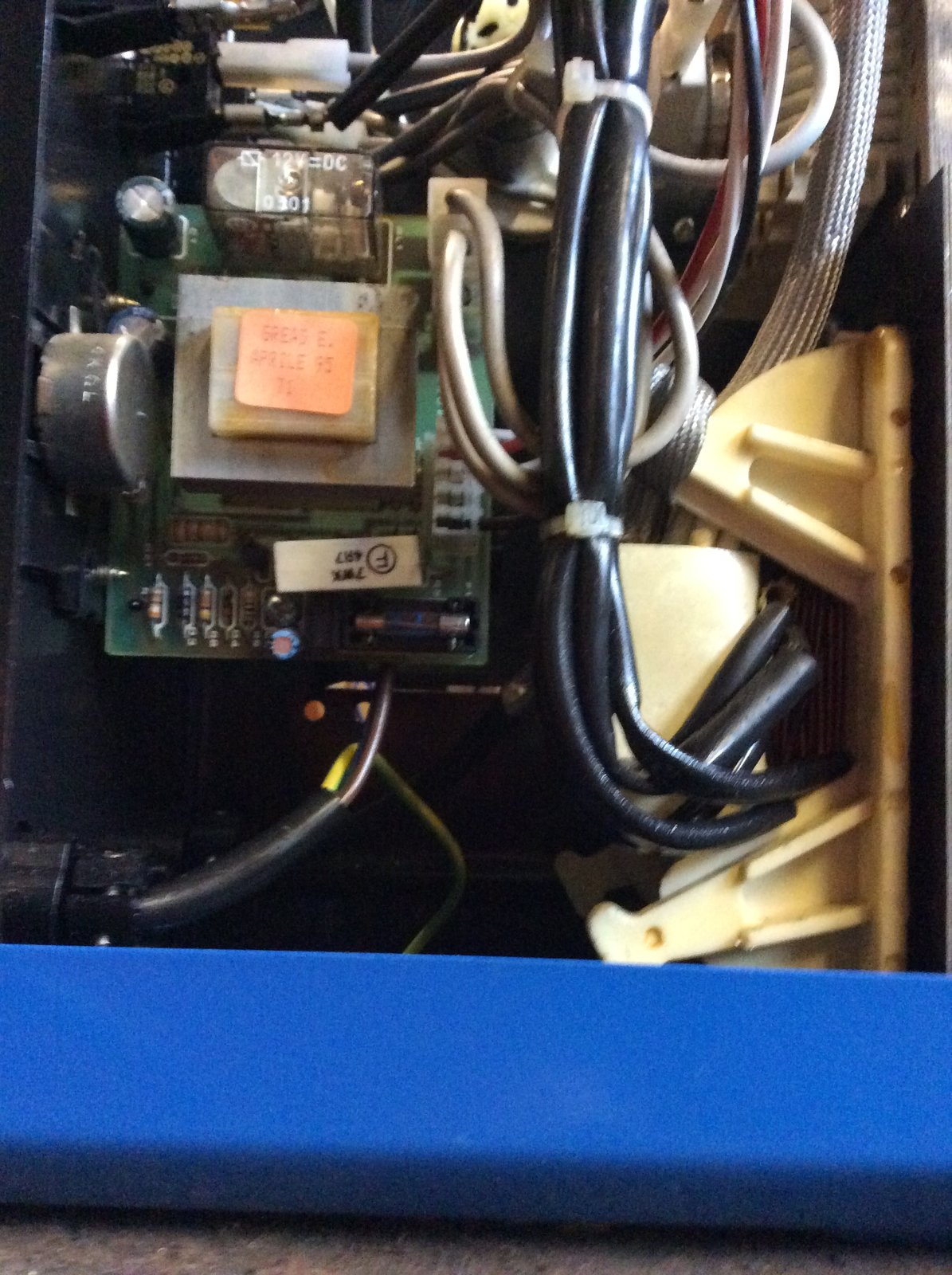

I am in the process of converting my Telwin/NU mig 100/1 welder from a live torch to a non live torch.
I have a number of questions
I need to install a gas solenoid where do I get the power from for this?
The new non live torch has two wires coming from a switch in the torch, where do I connect these two wires to?
Does anyone have a wiring diagram that shows the best place for connections to be made??
Any assistance would be appreciated.
