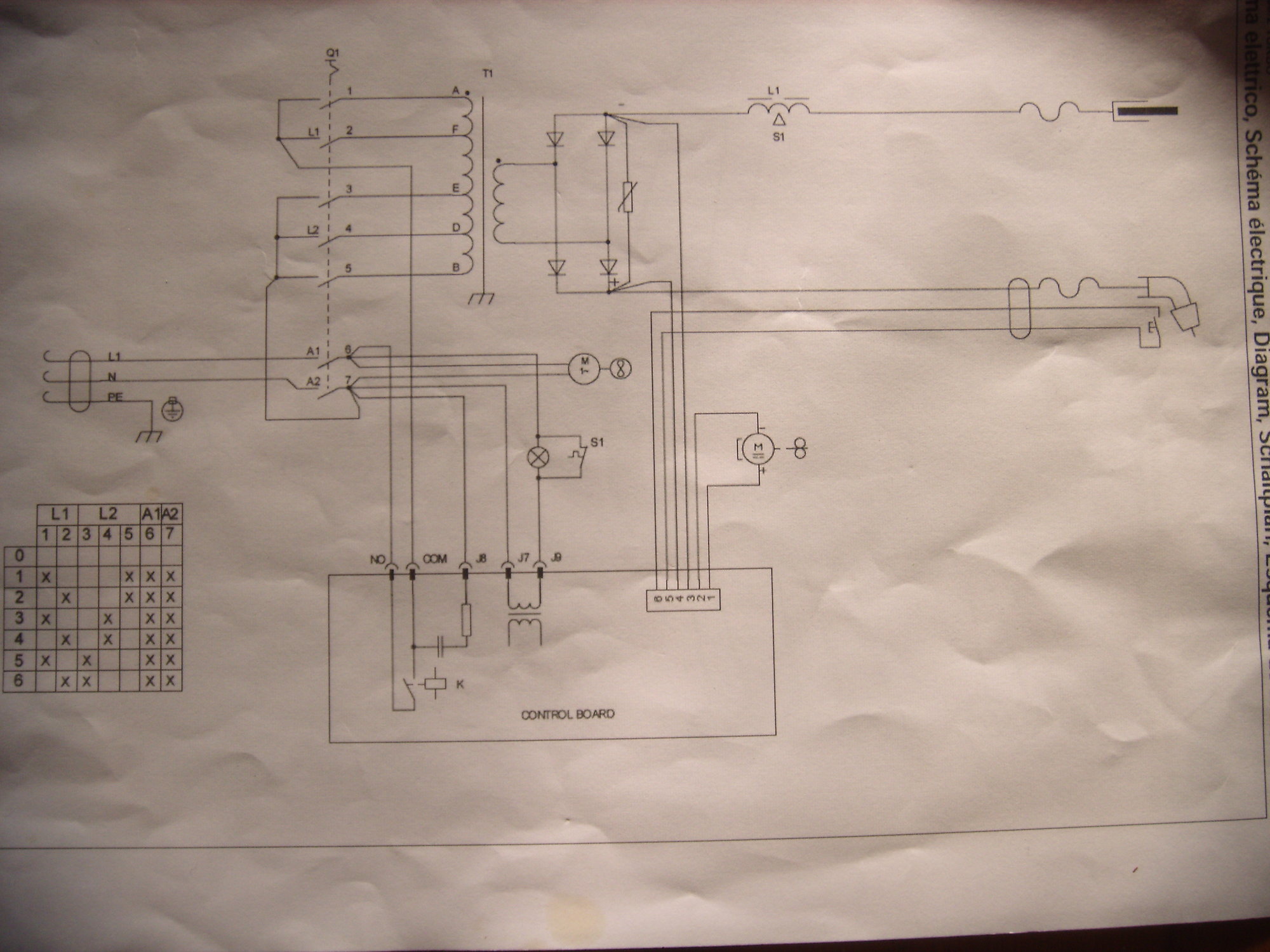

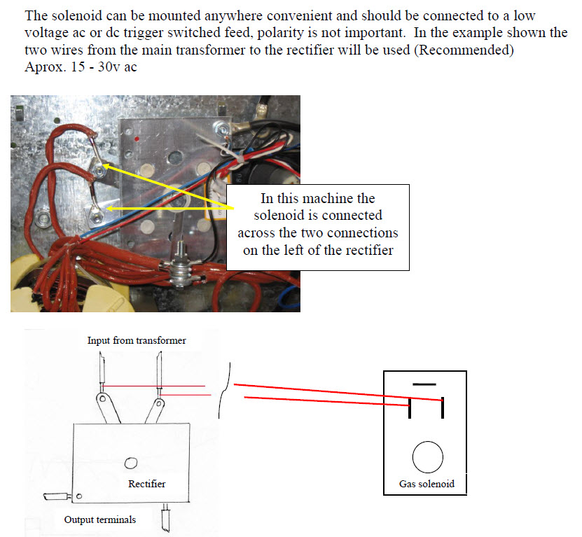

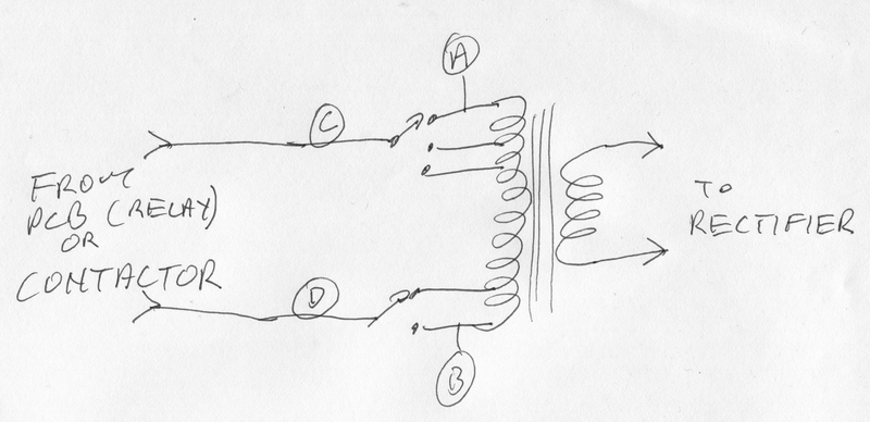

I'm not happy about connecting the valve to the rectifier, the voltage will vary with power setting and the welding current.
"The power selector is the main power switch too. "

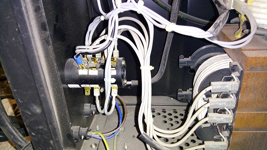

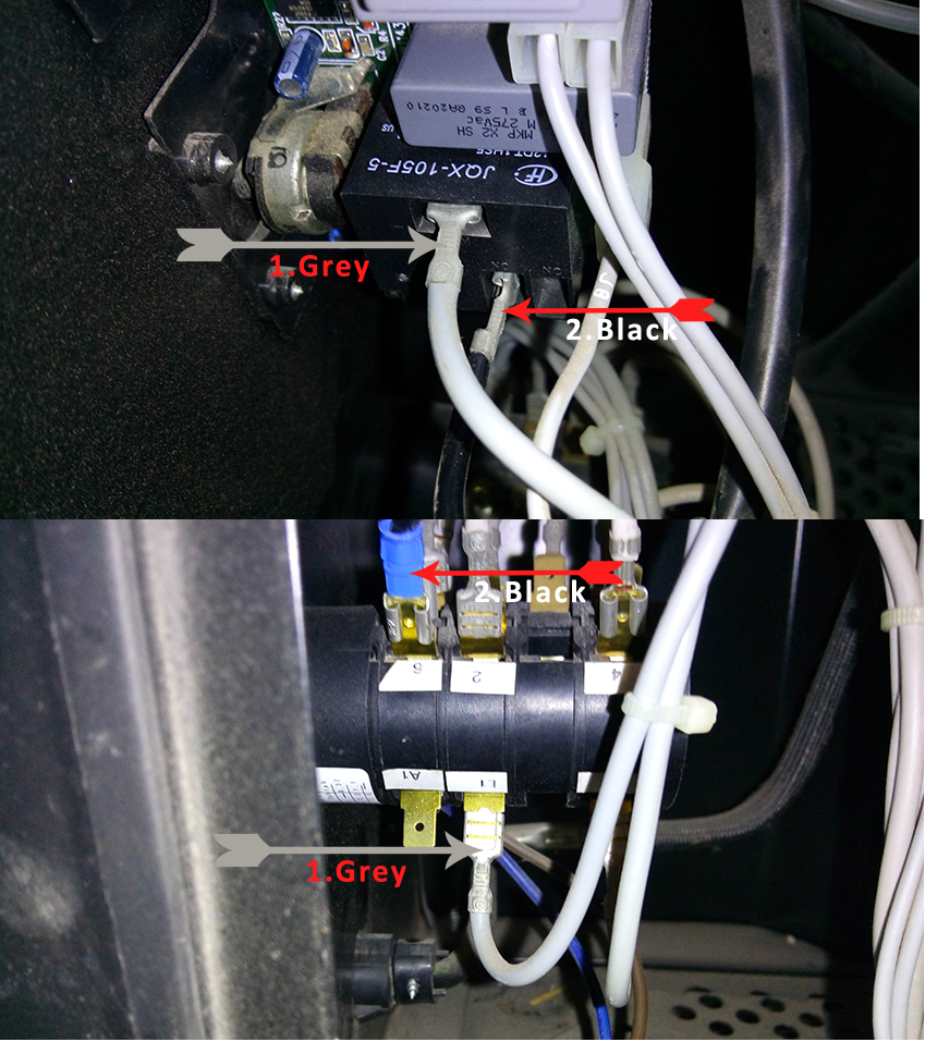

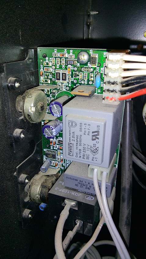

In that case the power switch must also put out a supply to the PCB.
Follow the mains input lead, do both the live & neutral go to the power switch?
