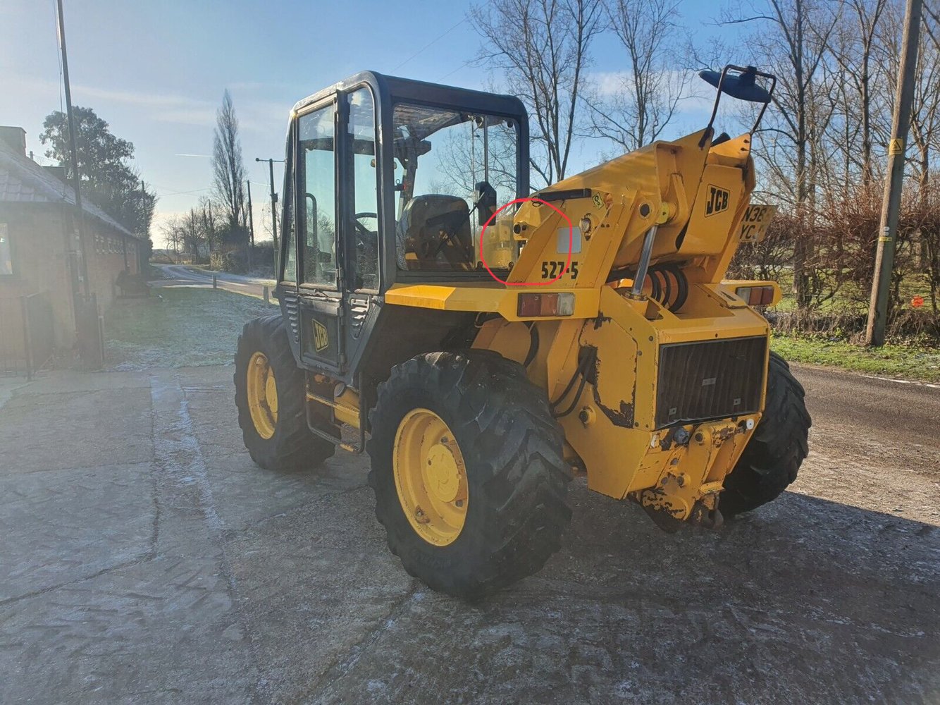

Farm special plus 527-58 1995ish
Direct valve control of bucket, not electronic.
I was scooping wood chip, tilting bucket up when there was a loud bang, and the tilt stopped working. No oil leaks anywhere. Everything else fine. With the boom out, I could see the tilt ram pins hadn’t sheared, and nothing else appeared broken.
Fiddling around, it appears the tilt does work, but there’s a delay like backlash. Operating the lever, I get a slight jump of the bucket, then a 3-second delay before it starts moving. Once the lash has been taken up, it works normally in that direction. Lash then re-occurs when I go the other way.
Delay is less when the engine revs are higher.
Sounds like the ram piston has come loose from the shaft. Is that possible, or any other explanations?
