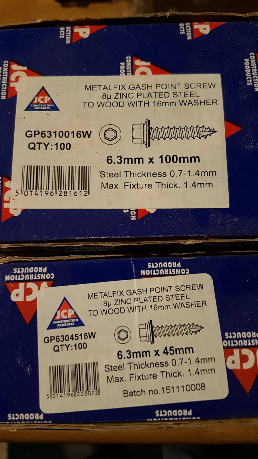

I used these for mine, the top box for going through 50mm of insulation then into the purlins, the bottom box for straight into the purlins.One for the roofing guys , what length of tek screw to secure roof sheets to softwood purlin ??
Thanks in advance
Chris
