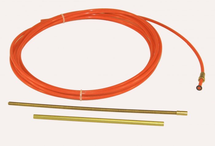

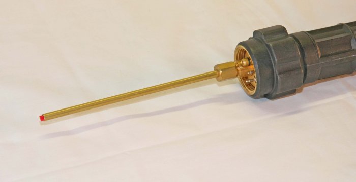

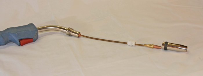

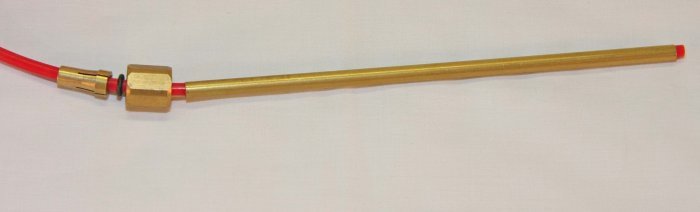

You may have seen this style of set up before, but this is how I set up a euro gun (Binzel style) to Mig weld ally. The best part is that the liner goes right from the drive rollers in one piece all the way to the neck where there is a neck spring screwed on to the end of the liner, making it an easy to feed the ally wire
