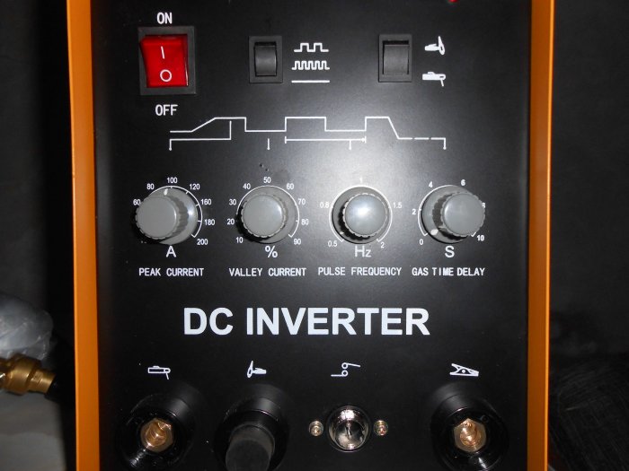

I have a TIG 200WSM with pulse and 3 way switch for higher frequency's. I just been messing about with it tonight to try find appropriate settings for a car sill. Listed below is what I'm using and settings.
1.6mm grey tip tungsten
1.0mm filler rod
1.0mm steel sheet
5 Ceramic Cup
Pure argon (disposable bottle) just tap no regulator
30amp
flat line no pulse
My problem is tungsten burning down and awful unstable arc. From reading on here it looks like what causes this problem is gas flow. Am I going to have to quickly work out how many turns on the tap for gas flow or will the welder distribute the gas accordingly when the gas tap is fully open???? Should I use a larger cup????
my attempts left a kind of black looking weld at times. Managed to get about 2 decent runs a few inches each with filler rod but like I say the tungsten is burning down so fast. Quite annoying as my tig welding has always been good only when ive been using a system already set up. Now im having to set up my own system and just want to get the setup proper as argon aint cheap lol
