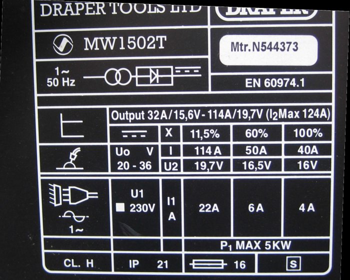

Draper MW 1502T
Anyone give me the rating 120, 140 150 etc
Put pub gas co2 on and have 4 settings 1 and 2 min max
Seem only to lay bead (beginners) on 1 max and 2 max
rest sits on top of 3mm angle
Thought details might find me a manual as Draper = too old although clean and tidy.
Appreciate any help
