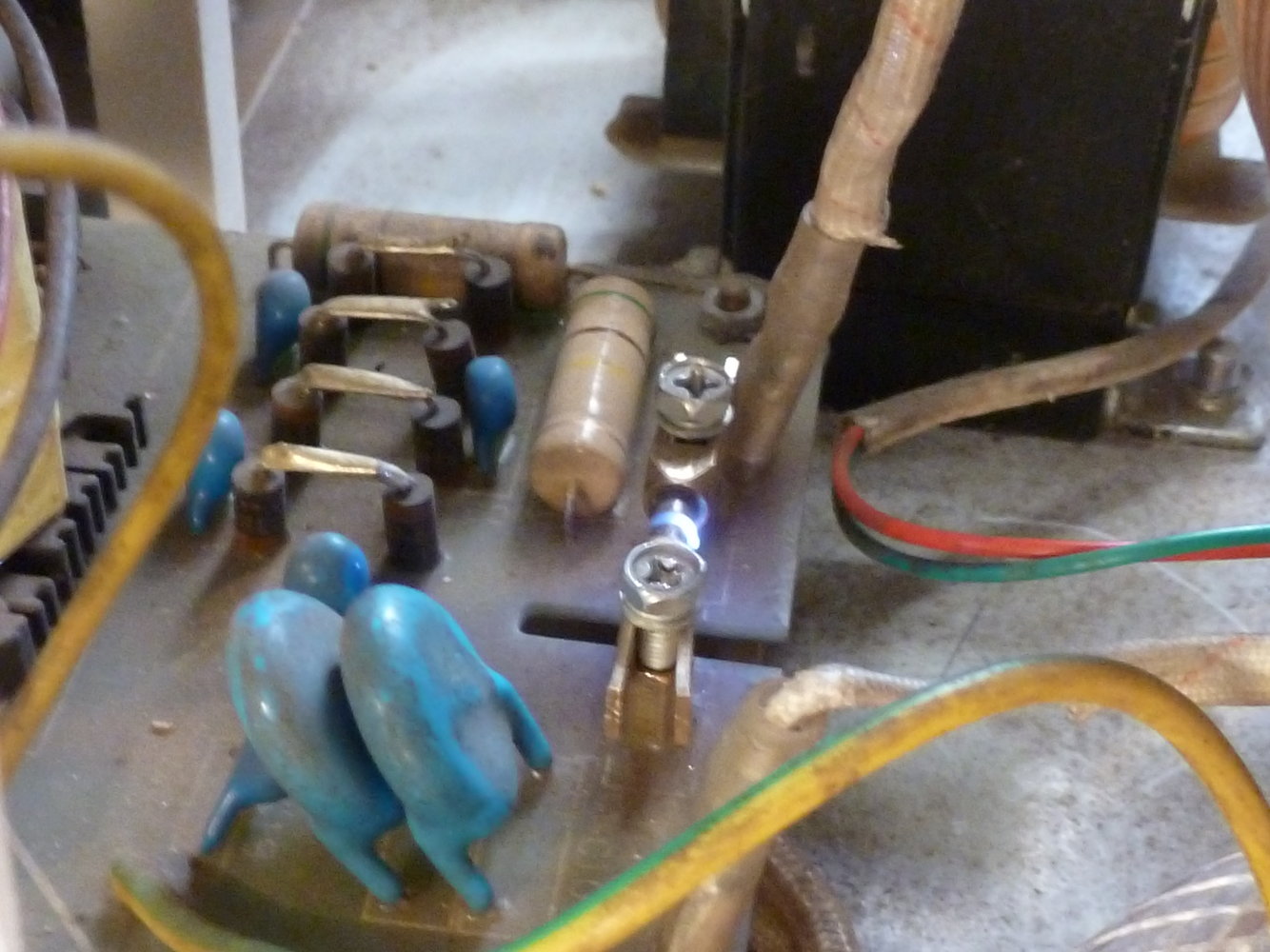

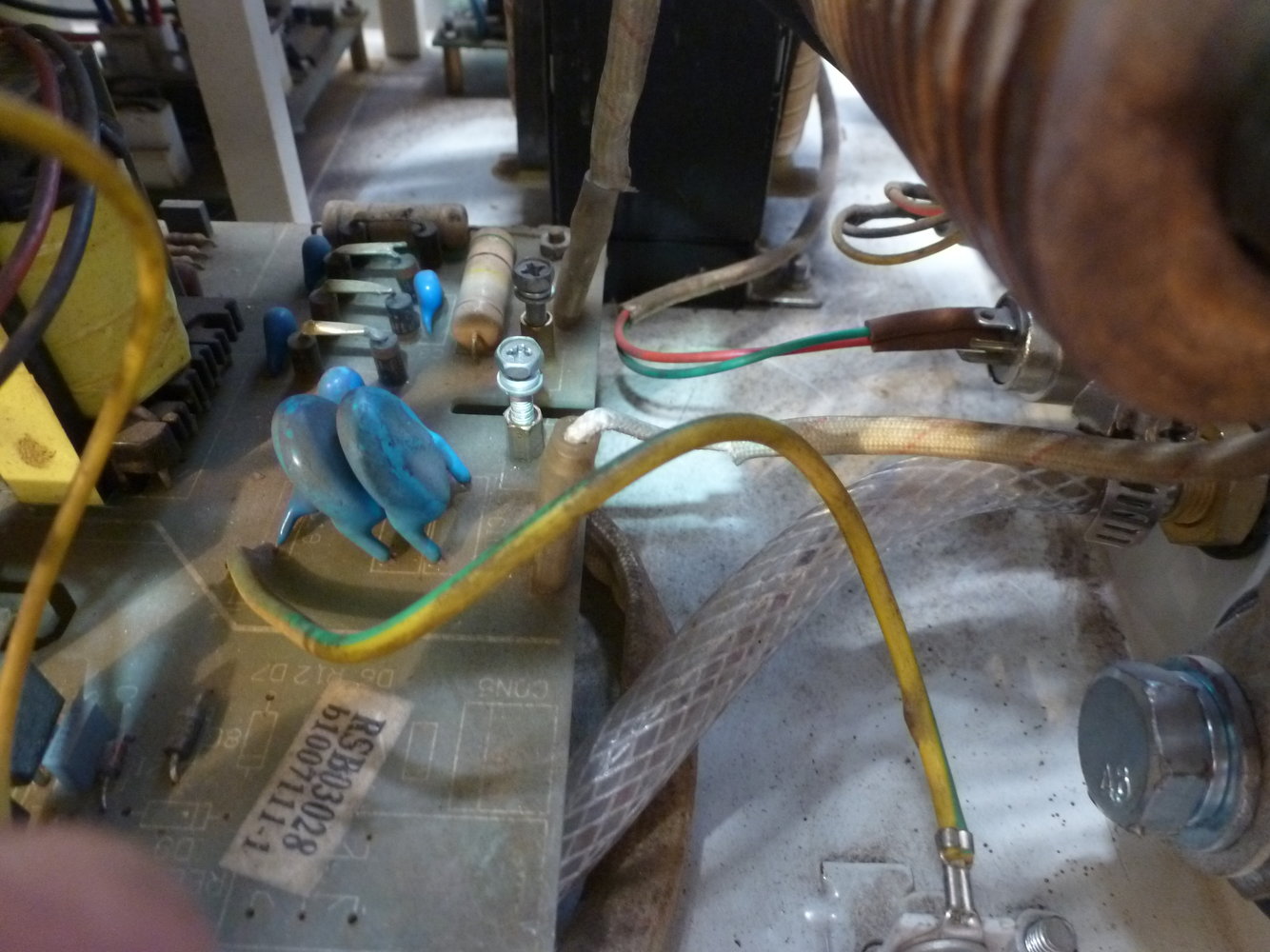

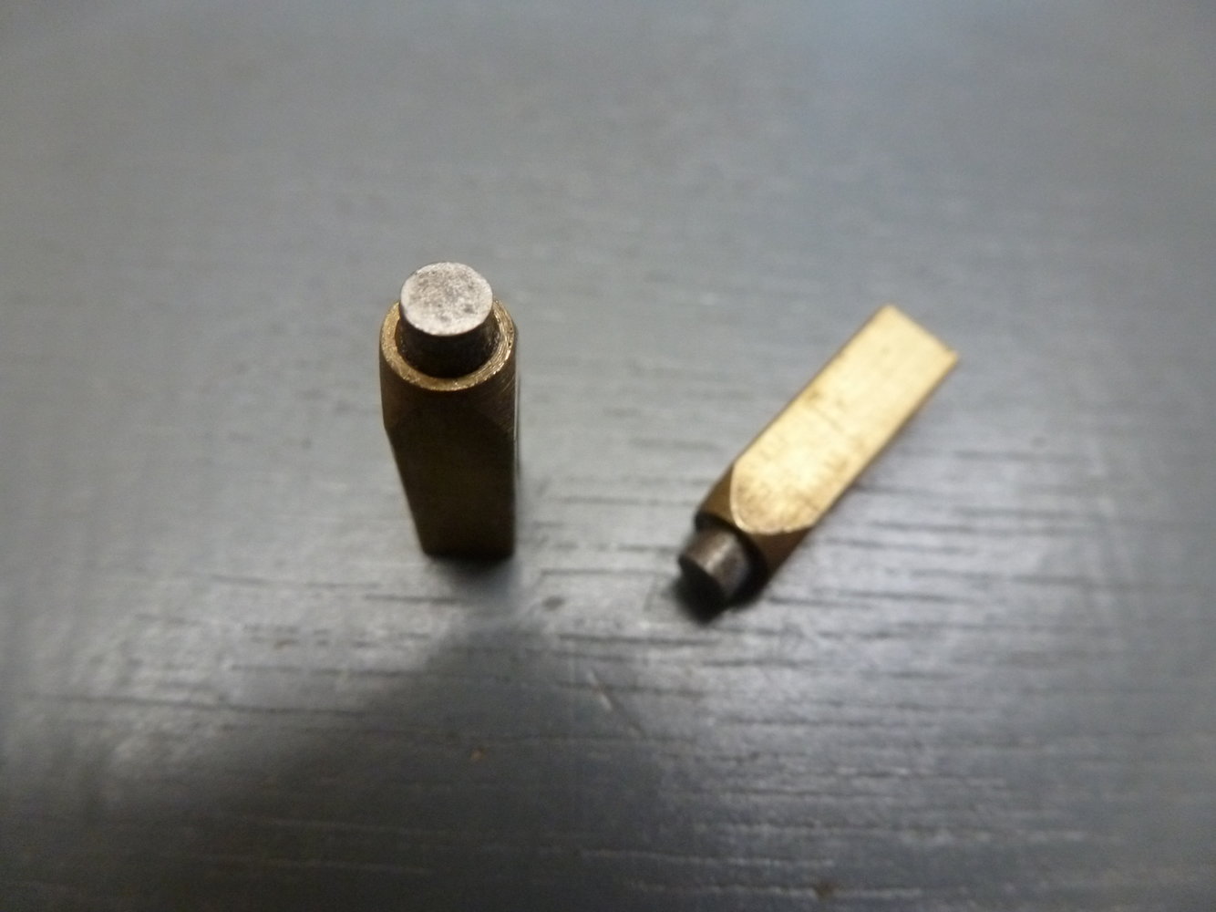

I have posted some photos below of a small procedure which should be of interest to some members who own a TecArc Welder.
1. Remove the electrodes
2. Clean the electrodes with a small file or wet & dry paper
3. Re-install the electrodes
4. Set the spark gap to 0.9mm
See photos below................................
