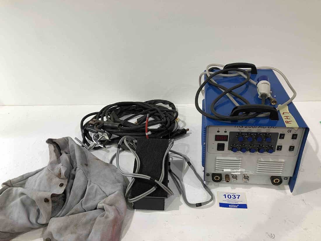

That's my machine in the 12 year old thread and still welding okay. Looks like an Arc stinger, Tig torch and return in the pile of leads along with the overpriced pedal.Well, not exactly "made", more "reworked". It is one of the generic early analogue-controlled Chinese TIGs, rebadged by TecArc.

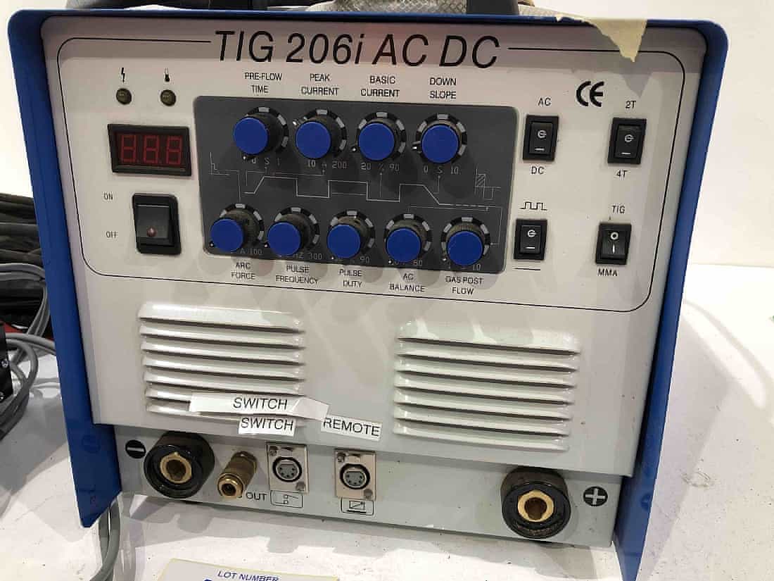

Wallace, regarding your HF start issue with your TecArc 206i. Remove the case and clean the HF contacts with some 600 grade automotive grade paper.That's my machine in the 12 year old thread and still welding okay. Looks like an Arc stinger, Tig torch and return in the pile of leads along with the overpriced pedal.
