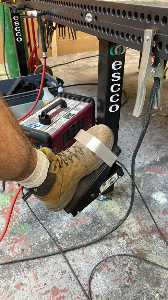

Hi there, new to the forum! I'm running a Thermal Arc 202 AC/DC tig welder and recently bought a TEC Arc foot pedal to use with it - the proprietary foot pedal from thermal arc was out of budget. The issue I'm having is that the amperage control is inversed, meaning I have max amps at the top and low amps when the pedal is fully pressed, which results in sometimes getting a huge spike when I back off and the arc burning a huge blob into the end of my weld. Obviously getting the OG pedal is the best solution, but I was wondering if anyone had experienced something similar with after market pedals and if there was an obvious fix. I have tried switching the max/min wires inside the pedal but this results in not being able to control the amps on the machine. Any advice would be greatly appreciated.
