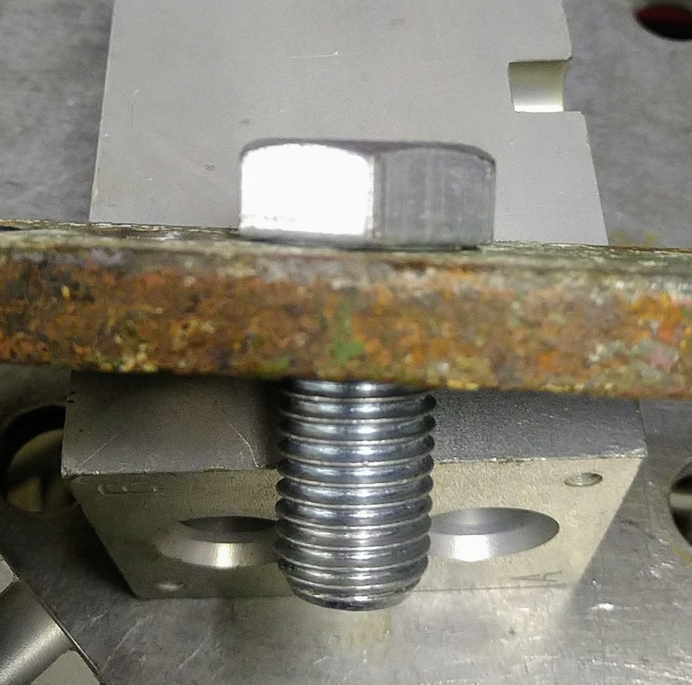

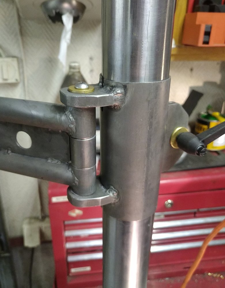

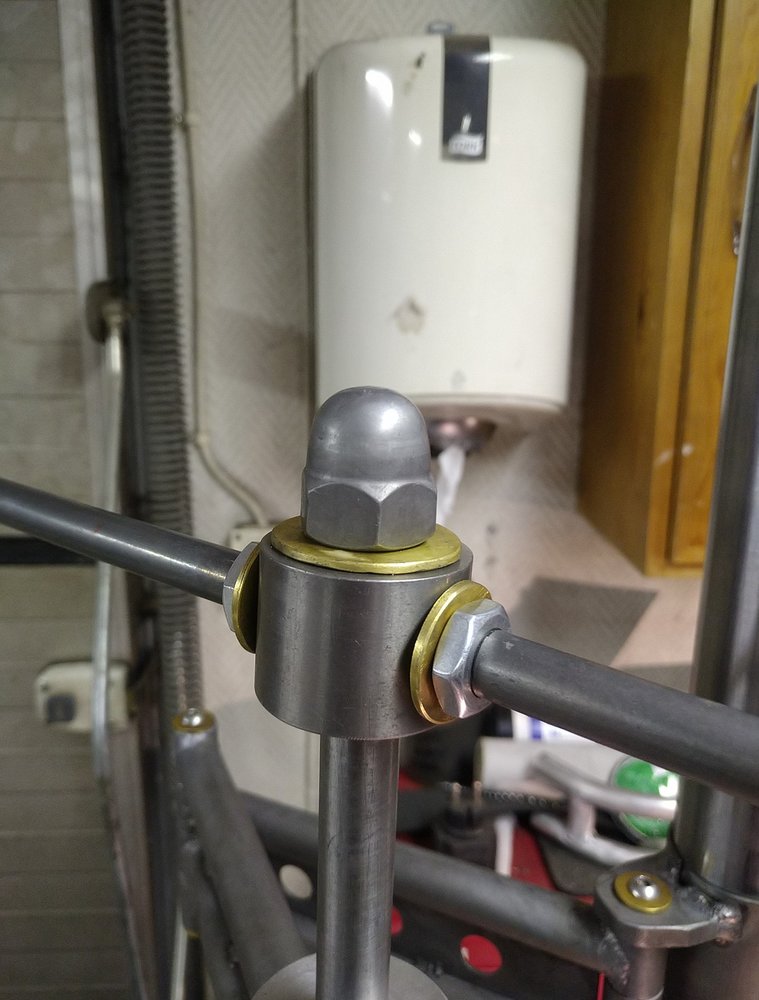

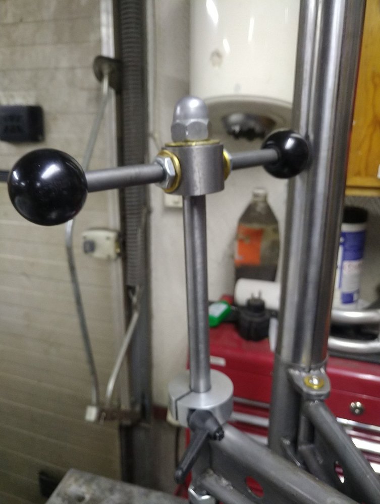

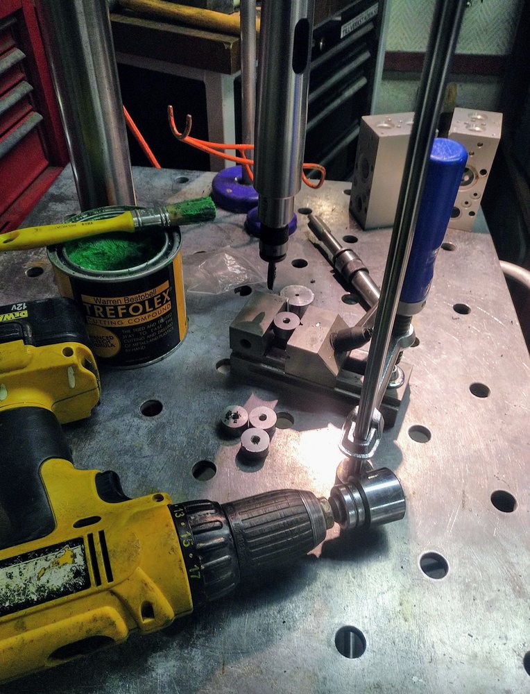

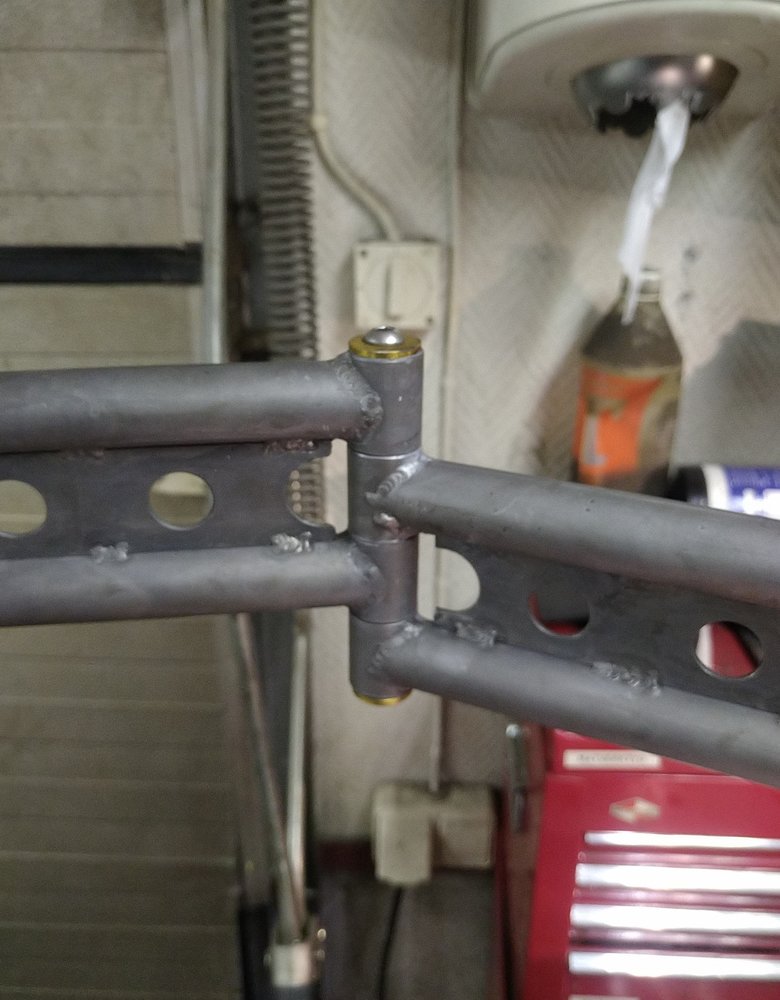

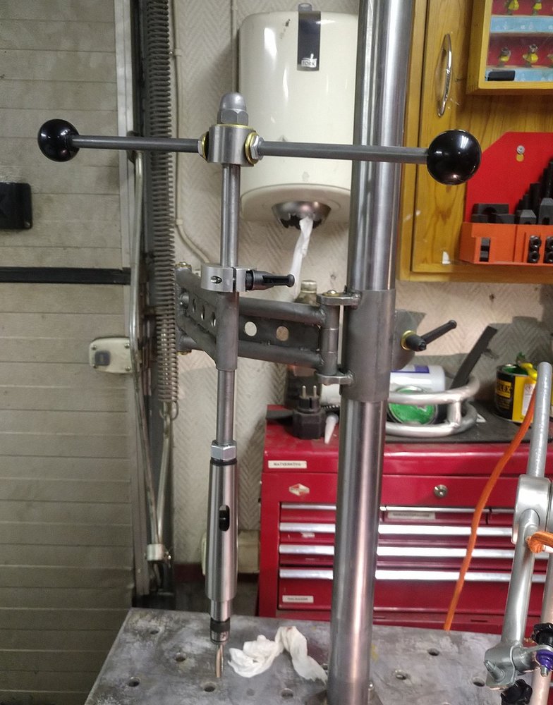

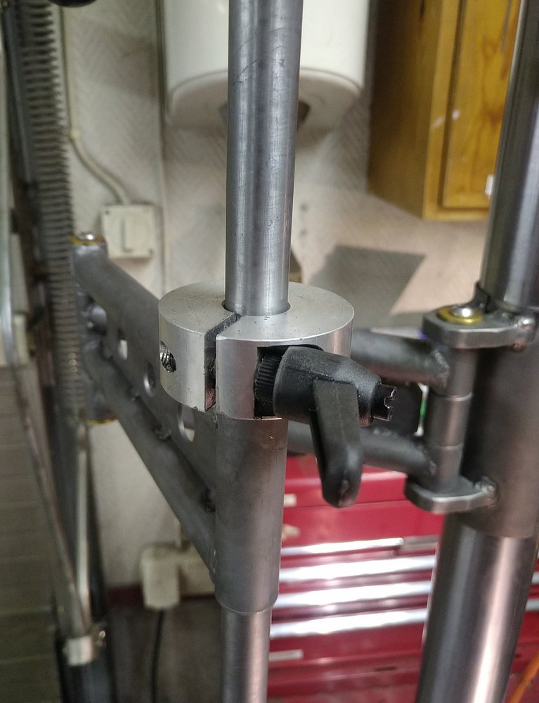

Been making parts for a tapping arm and got it all together tonight.
Everything is engineering on the fly and all fabricated parts of material from the " good to have" box.

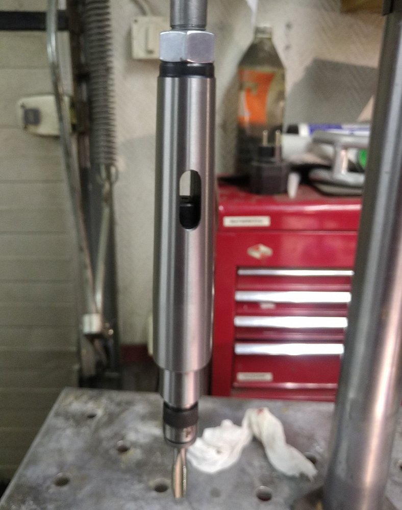

I made it so I can use special MT2 tap holders as well as a regular ER chuck.
Using a MT4-3 reducer for drawbar then reduce it further to MT2. A little bulky but the MT3-2 reducer for drawbar was out of stock. I'll order one later.

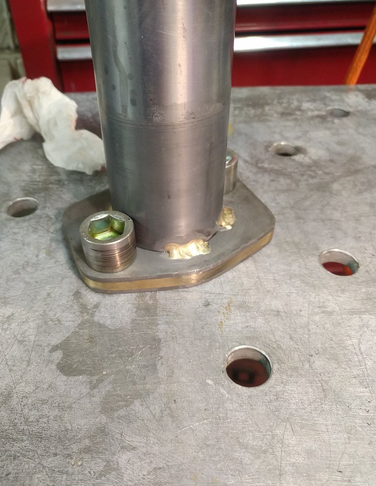

For now I can mount it to the weld table but I'll also make a separate mounting plate.
Need a little twisting to get fully perpendicular to the table but close enough already.
