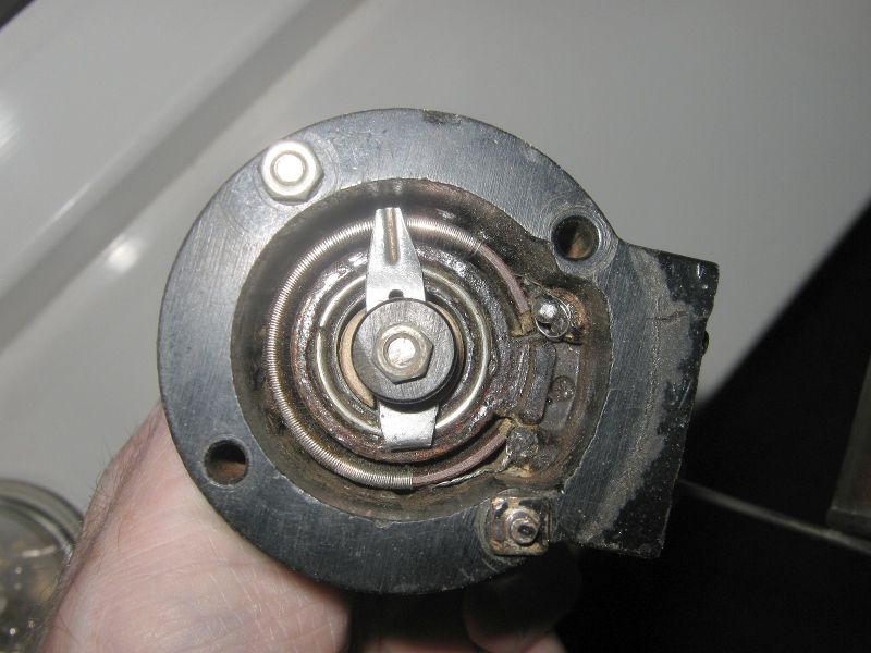

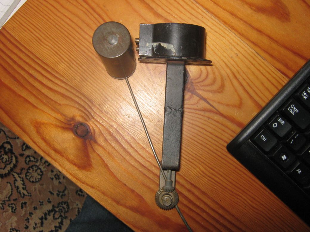

The tank sender unit as received through the post.

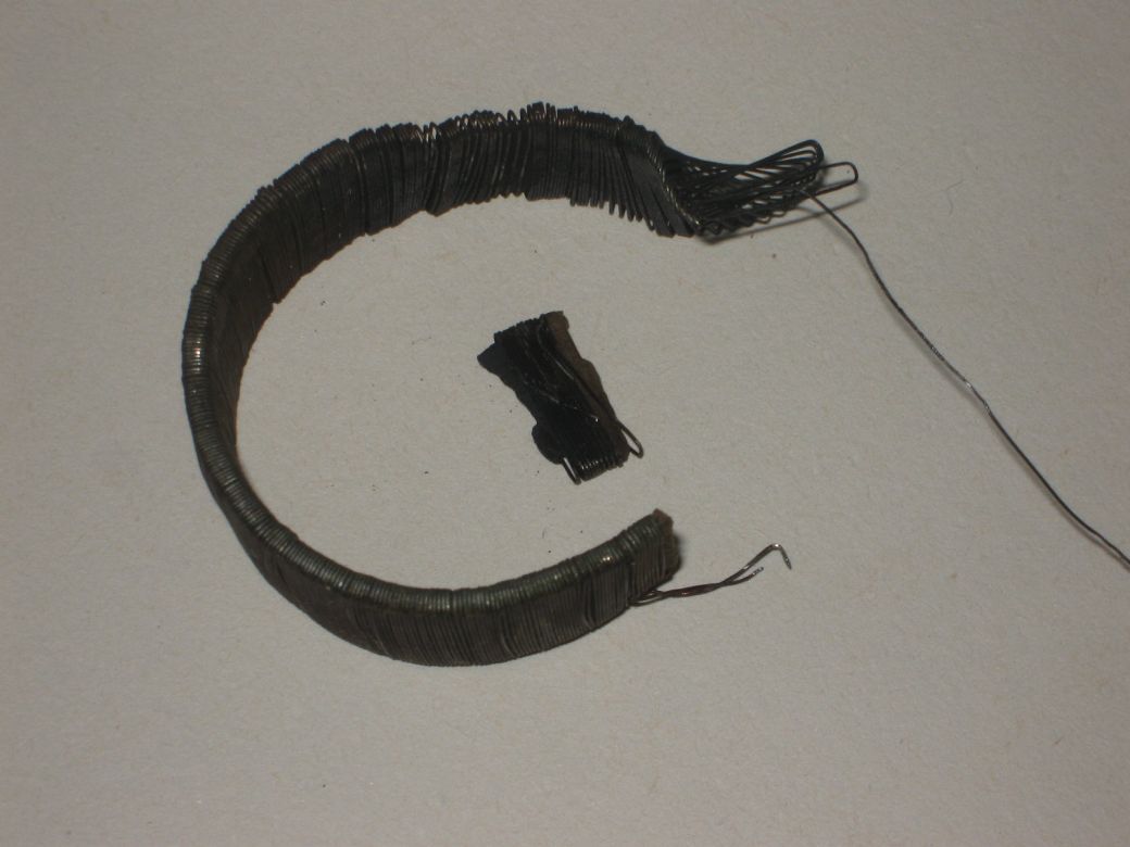

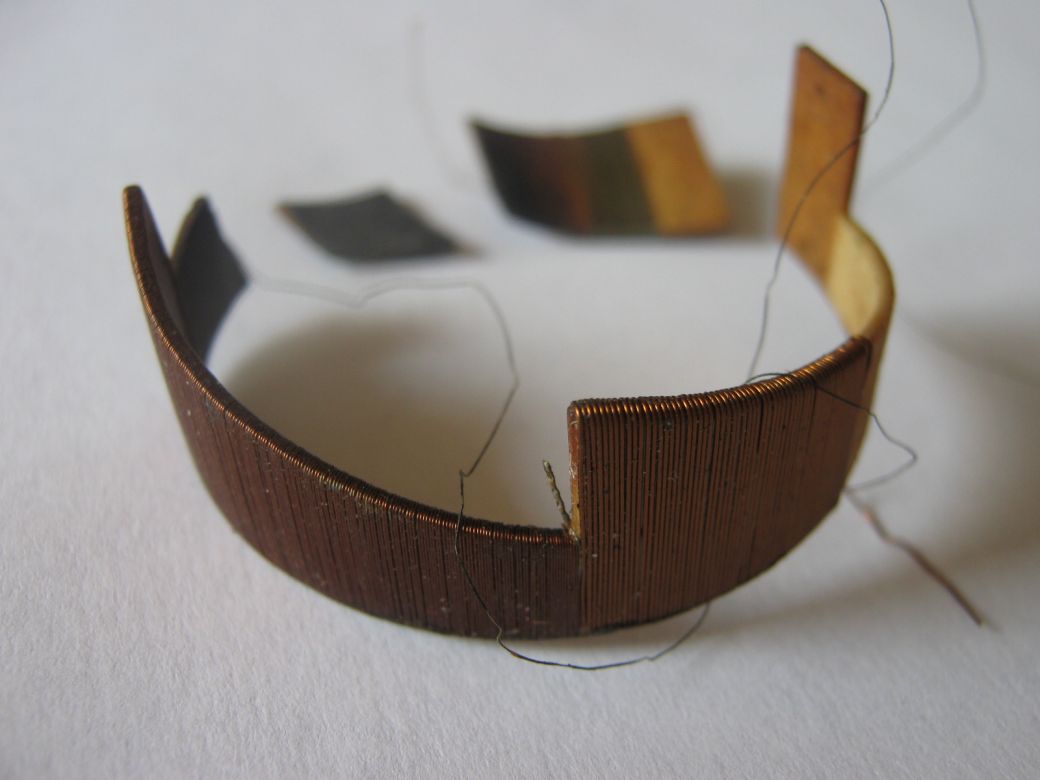

This is the sender unit potentiometer track in very sorry condition; it was a challenge and as it was giving a wrong reading it meant starting from scratch so a bit of frustration was in order.

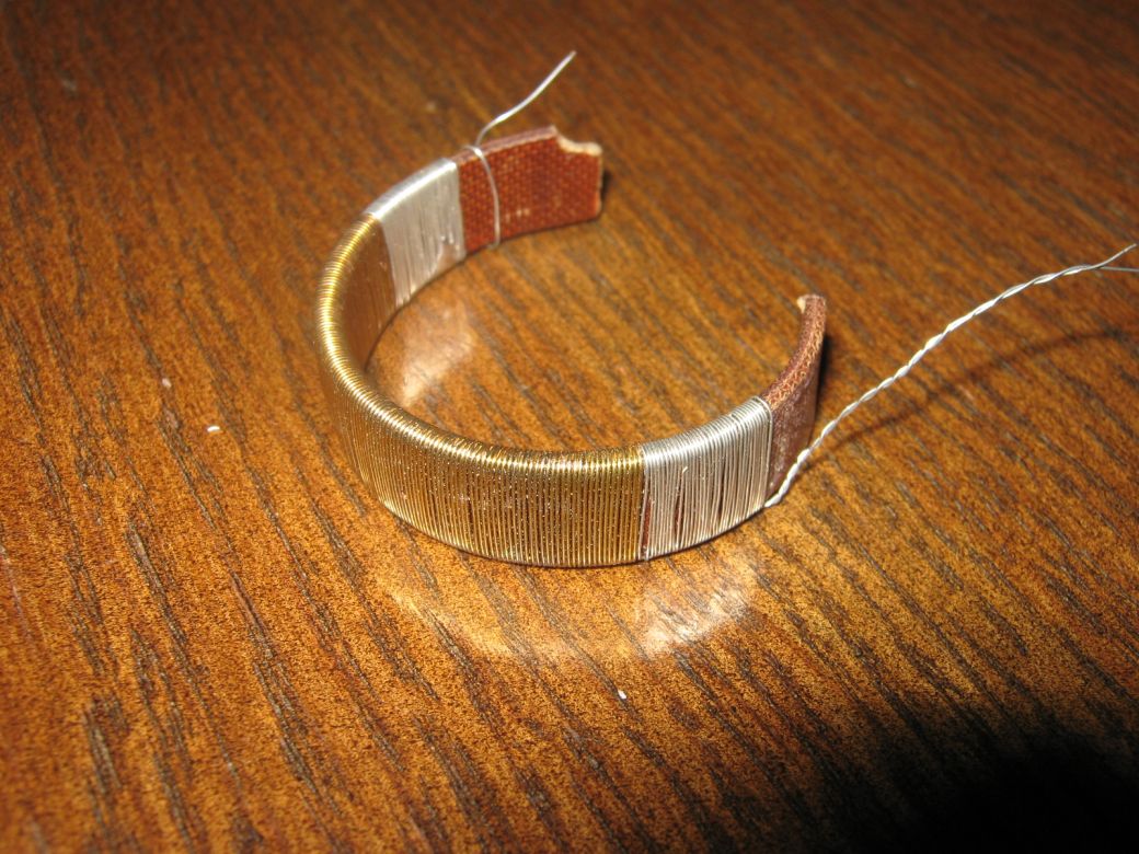

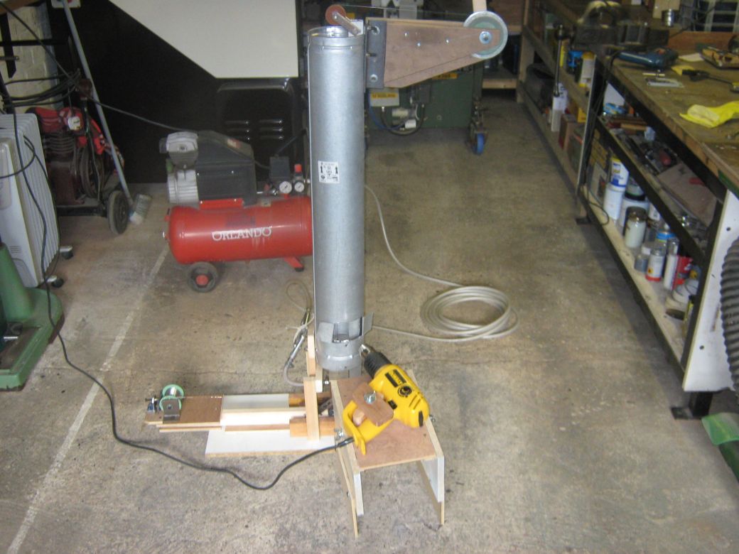

Here the resistance wire is being coated with special varnish where I set up to run it through an heater to dry the varnish as seen.

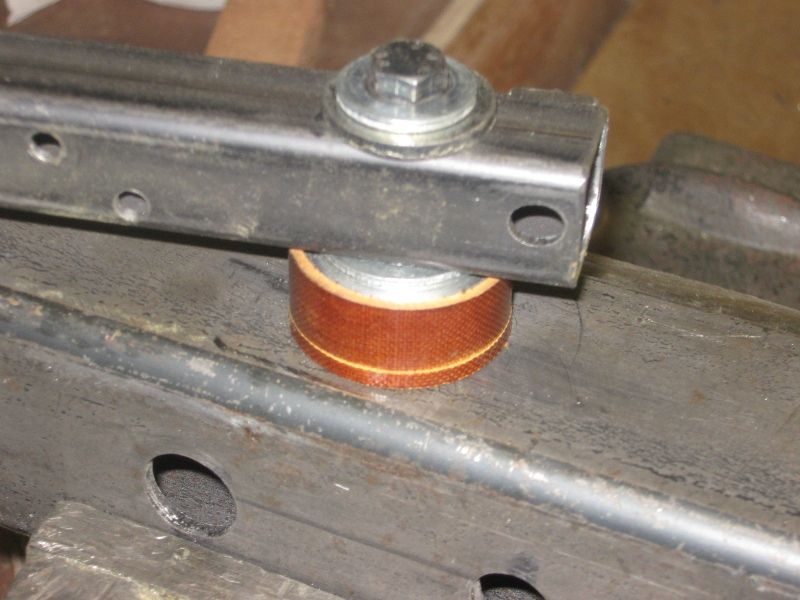

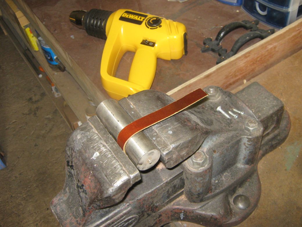

Whale Tufnol was chosen for the new track former; I was familiar with this Tufnol having used it on other radio projects. I wondered if I could heat form it around a steel bar here seen experimenting as a first stage.

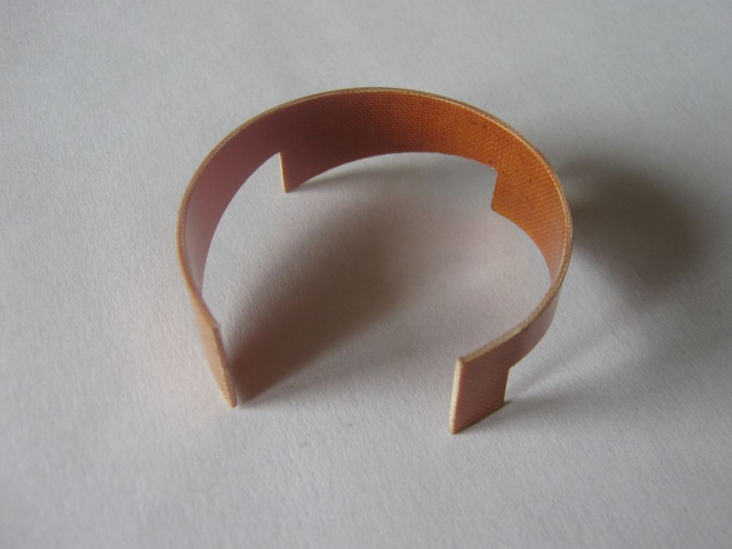

The new potentiometer track completed ready for installation into the sender unit.

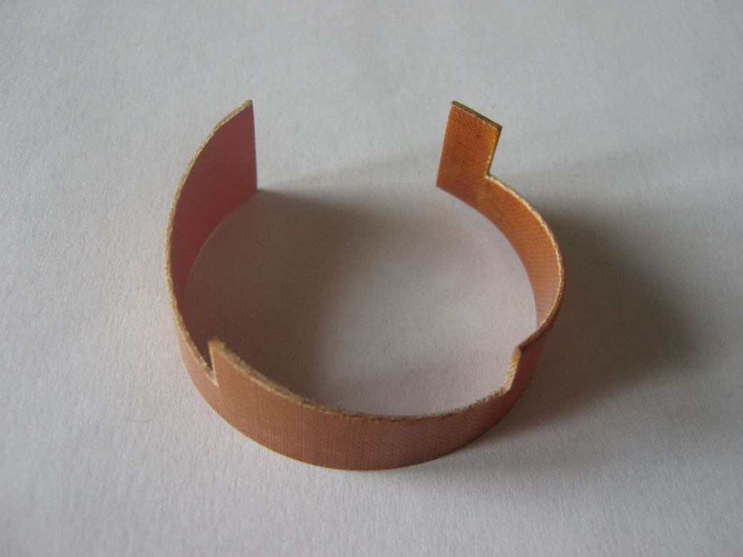

Having experimented and discovered the Whale Tufnol could indeed be formed into a track profile by heating I designed and made a forming tool seen in action; heat was directly applied using a cartridge blow torch taking care not to burn the Tufnol; once formed the new track was left in the forming tool until everything was cold.

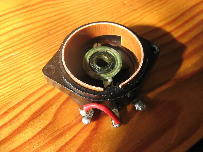

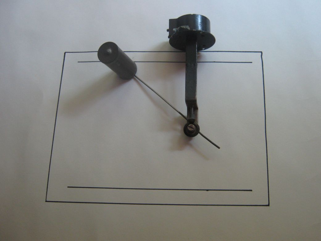

The new track fully installed and working. The replacement petrol gauge was reading 50 Ohms on full scale but only reading half full; this new bespoke track was now 50 Ohms on full scale which was perfect. I matched the track to the float travel between empty and full.

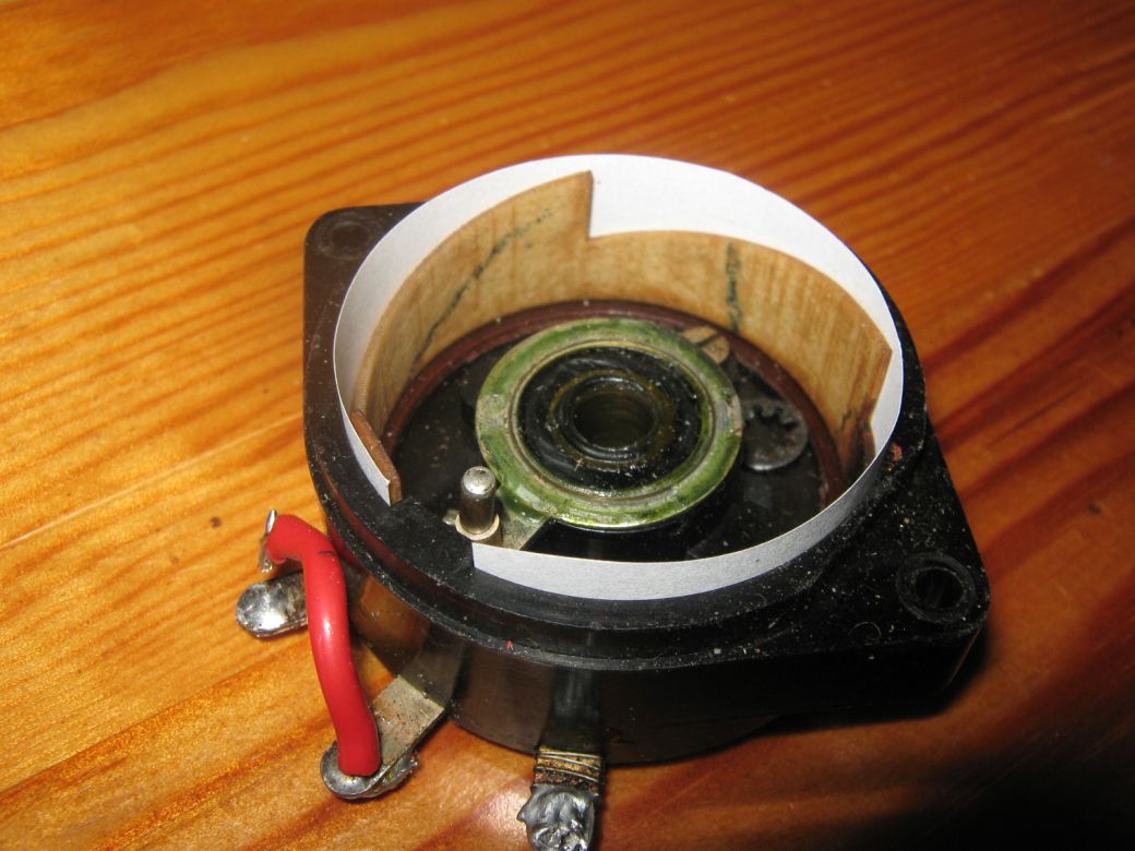

After heat forming I checked to ensure the new track actually fitted and it did much to my delight.

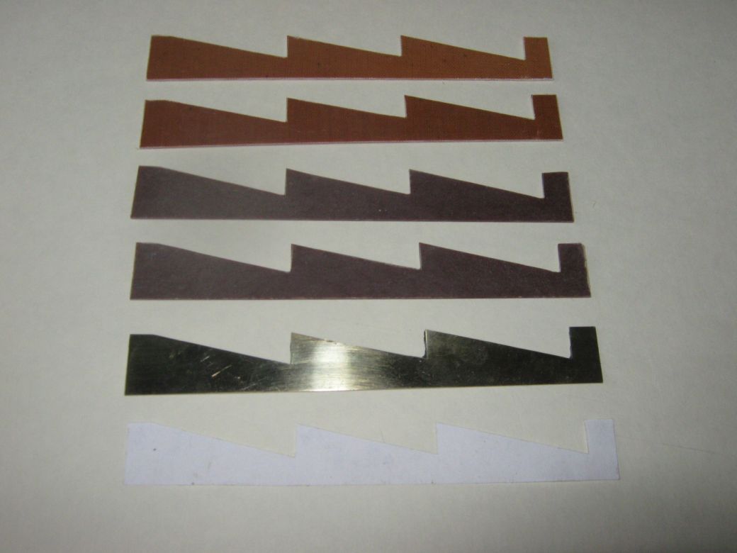

Rather than spending forever researching I thought up this very simple method of obtaining the float sweep from empty to full noting the potentiometer reading in degrees and used the finding to work out the resistance wire details. Once the solution is known then it looks so easy.
