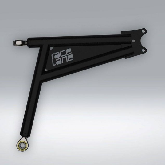

K keithski122 Member Messages 2,074 Mar 13, 2021 #1 I saw this on instagram and to me the rose joints look to be fitted in such a position they wouldn't work or might work but be at the extreme of their angle. Am I right?

H hotponyshoes Member Messages 7,948 Location Somerset. Uk Mar 13, 2021 #2 I think that might just be rotated that way for the photo. Or it's for something with very limited travel?

Woody.v8 Blue gluer Messages 4,227 Location staffs Mar 13, 2021 #3 I'm taking it the picture is of a top down (or birdseye) view, it would work fine.
pedrobedro Man at Matalan Messages 13,099 Location CX near Chesterfield Mar 14, 2021 #4 One of those is a swivel and the other replaces a metalastic bush, spherical bearings will work fine in either orientation.

droopsnoot Member Messages 1,453 Location South Cheshire, UK Mar 14, 2021 #5 That's a very similar shape to my Mk1 Audi TT lower arms, and they have one bolt vertical and the other horizontal where they mount into the subframe.

8ob Member Messages 14,306 Location Nescient in the vale Mar 14, 2021 #6 Dont think I have ever seen such a poorly designed wishbone. Bob
pedrobedro Man at Matalan Messages 13,099 Location CX near Chesterfield Mar 14, 2021 #7 droopsnoot said: That's a very similar shape to my Mk1 Audi TT lower arms, and they have one bolt vertical and the other horizontal where they mount into the subframe. Click to expand... Our Berlingo uses the same but on a big lump of cast steel, most cars with Mcpherson struts do it this way.

K keithski122 Member Messages 2,074 Mar 14, 2021 #8 I've seen rubber bushed ones like this, just didn't think that rear bearing would take the angles needed from it.
