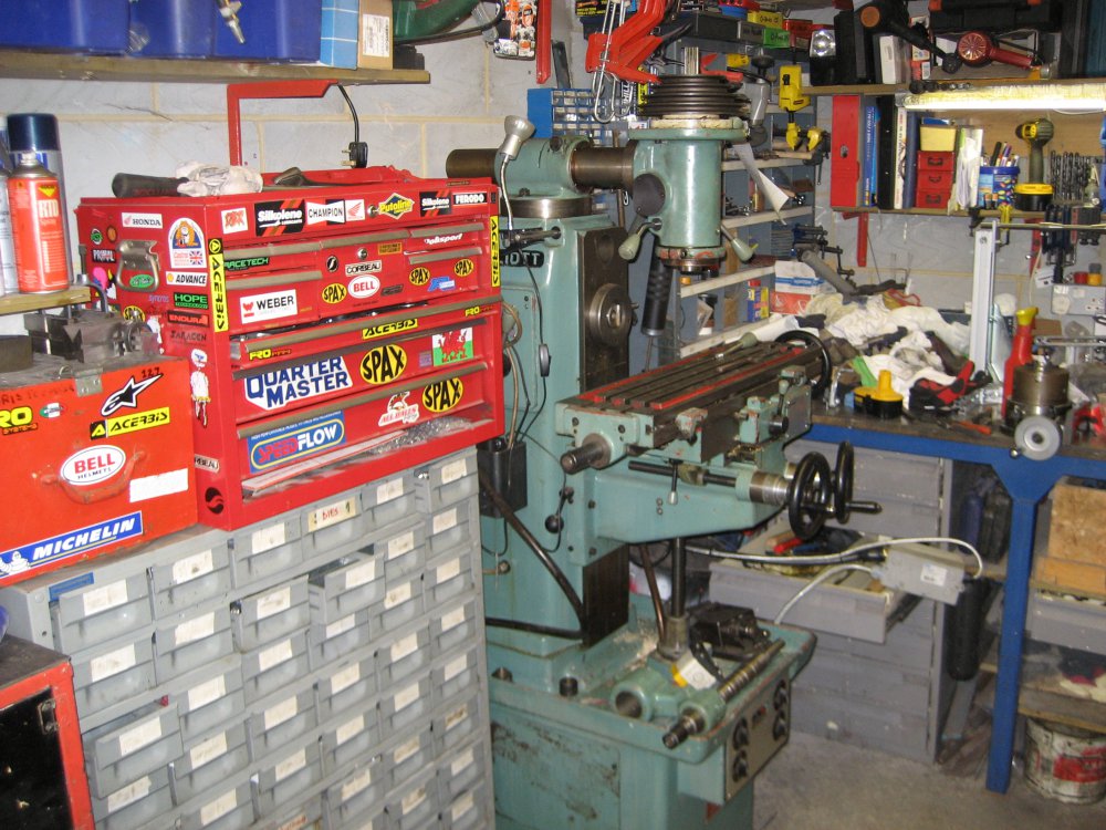

I bought a new toy today...!
Unfortunately its 3 phase and old enough that the motors cannot be rewired as delta to run on 230v three phase, otherwise I'd have just stuck one of these inverters on it and been done with it. As the 415V inverters are significantly more expensive, I am looking into all the options first.
Looking at rotary phase converters, but the information on the internet is rather confusing and often refers to American sites, where I believe that their 220v is actually 2 phase, rather than our single phase.
Is it possible to build a simple rotary phase converter that will give 415v output from a 230v input, that will give me a reasonable percentage of the motors original power and won't cause it to overheat after 30 seconds!
My other option at the moment is that I have got the motor from the vertical head in bits and it looks like the star connection is easy to get to, so I may split it, solder new wires on and rewire for delta.
