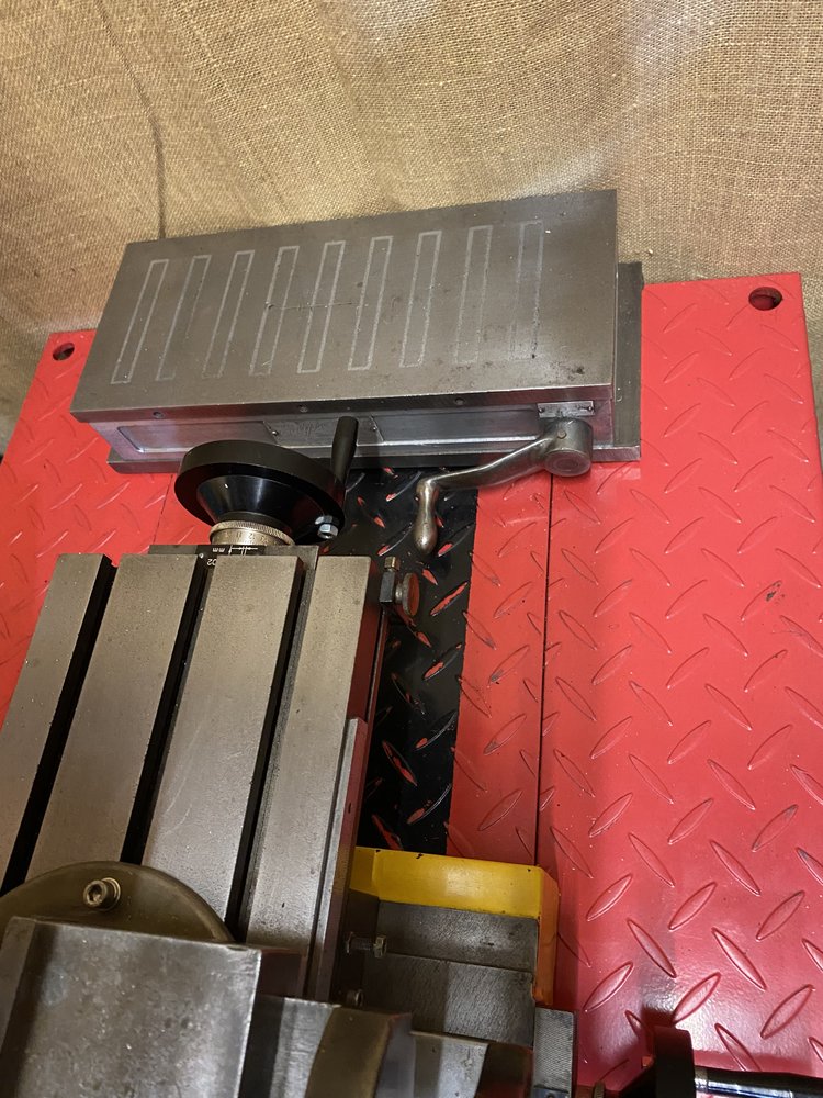

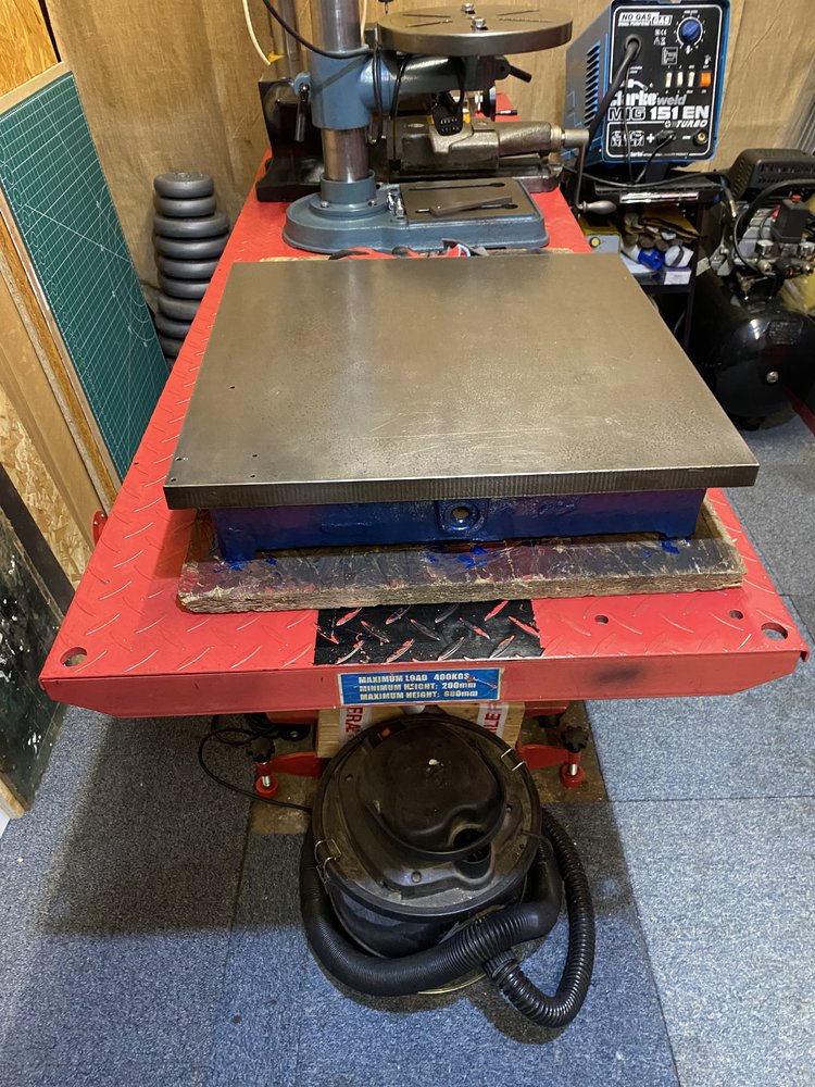

Want to take a bit of the wobble out of my bike bench / come work bench.
With the lock bars in and outriggers leveled & locked it still has some wobble at full height - aprrox 800mm, been fine for bikes but the top heaviness wobbles if doing other lateral heavy work on it.
It's got 20mm holes at each corner pictured. I could add 2 more central. Don't want the extra supports permanent so it needs to unbolt
Thinking 20mm zinc plated threaded rod, can get 10x1000 for £50, thinking in compression if straight enough should take the wobble out at 4 or 6 points?
Leveling feet wise, any ideas what I can use to screw in 20mm bar that won't cost a fortune?
Or any better ideas on a removable anti wobble setup?
