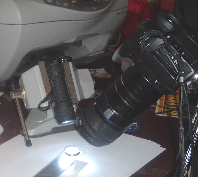

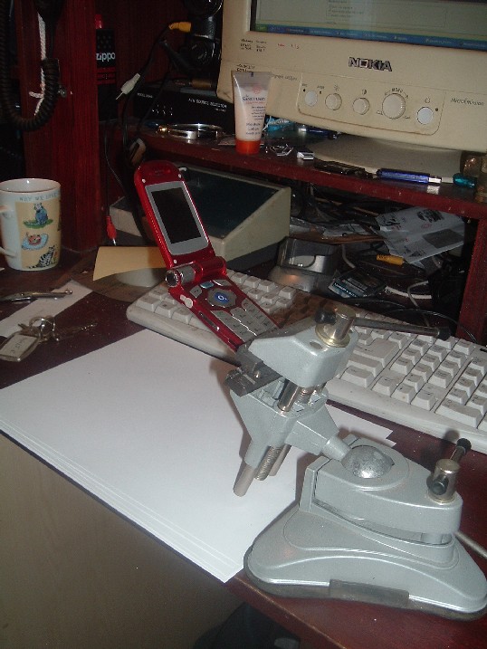

If using a phone camera support the phone as best as you can.I use this
and get as much light on subject as poss

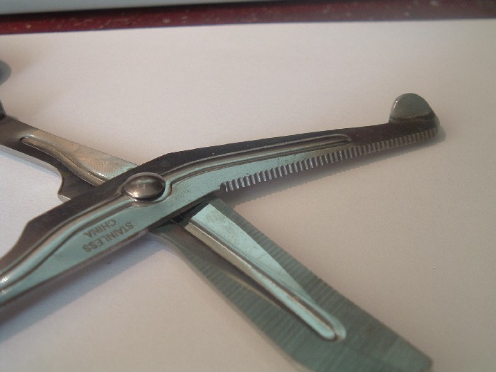

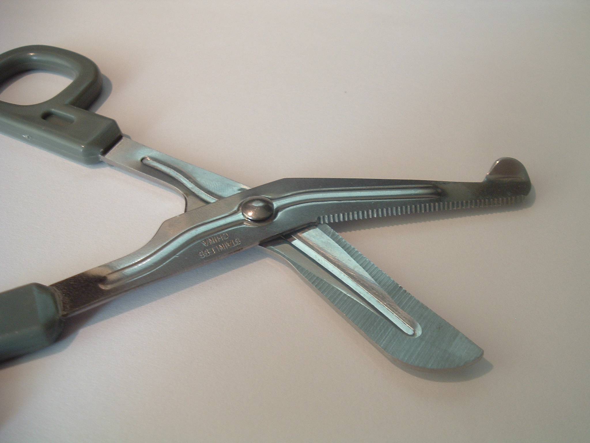

Here is a pic taken in normal mode at its closest where it would focus.I checked the focus by just half pressing the shutter button.Most cameras will give an indication when in focus or out of focus this one give a red AF! when out of focus
Link to full size pic http://m1cdq.co.uk/pics/migwelder/normal.jpg

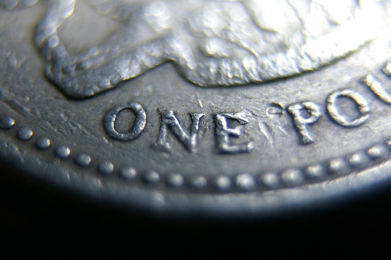

now same pic taken in macro mode with the camera as close as i would get before it would not focus any more
for full size http://m1cdq.co.uk/pics/migwelder/marco1small.jpg

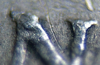

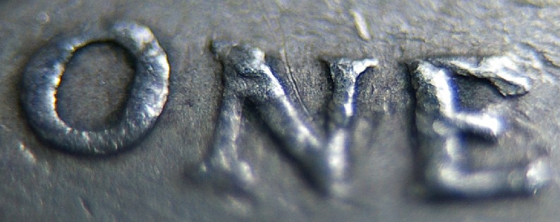

this pic is the same as above but I have cropped and zoomed 200%
I have not zoomed in on these pics only the last one all i have done is resize the from the original size down to a size for the forum.they are about 35% of the original size.

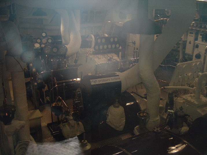

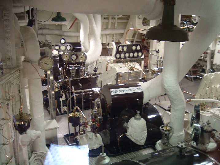

If your using flash and it has a shiny surface or glass.try to take pic at an angle and not straight at it other wise the flash will reflect back and make the picture darker or if you can turn the flash off and rest the camera on something.also if taking pics through Glass get as close as poss or even rest lens on glass as camera will try to focus on the glass and not whats behind it
example a pic taken of the engine room on the royal yacht through glass
taken with out flash. its a bit shakey as it was taken hand holding the camera.I could not rest lens on glass
