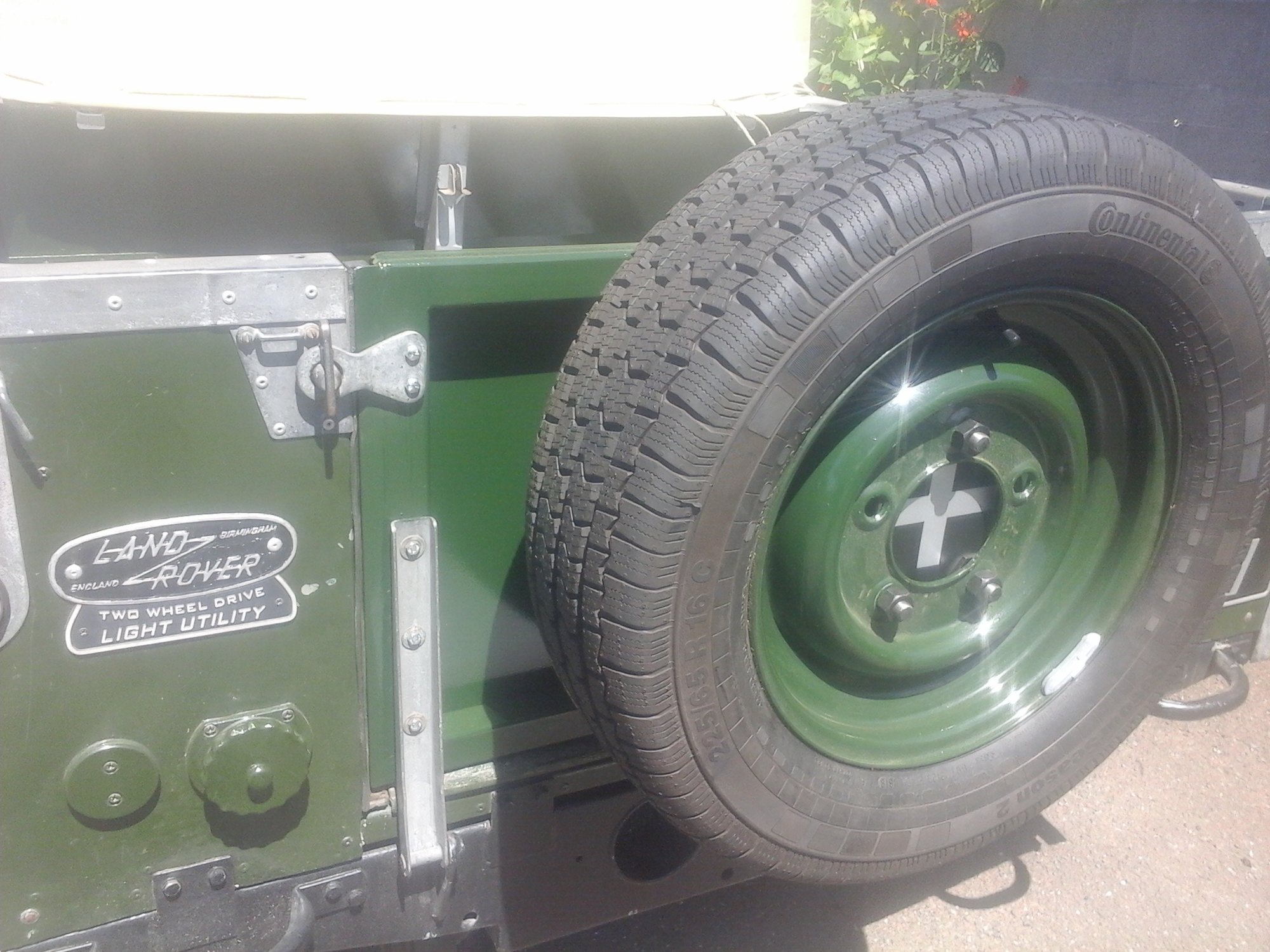

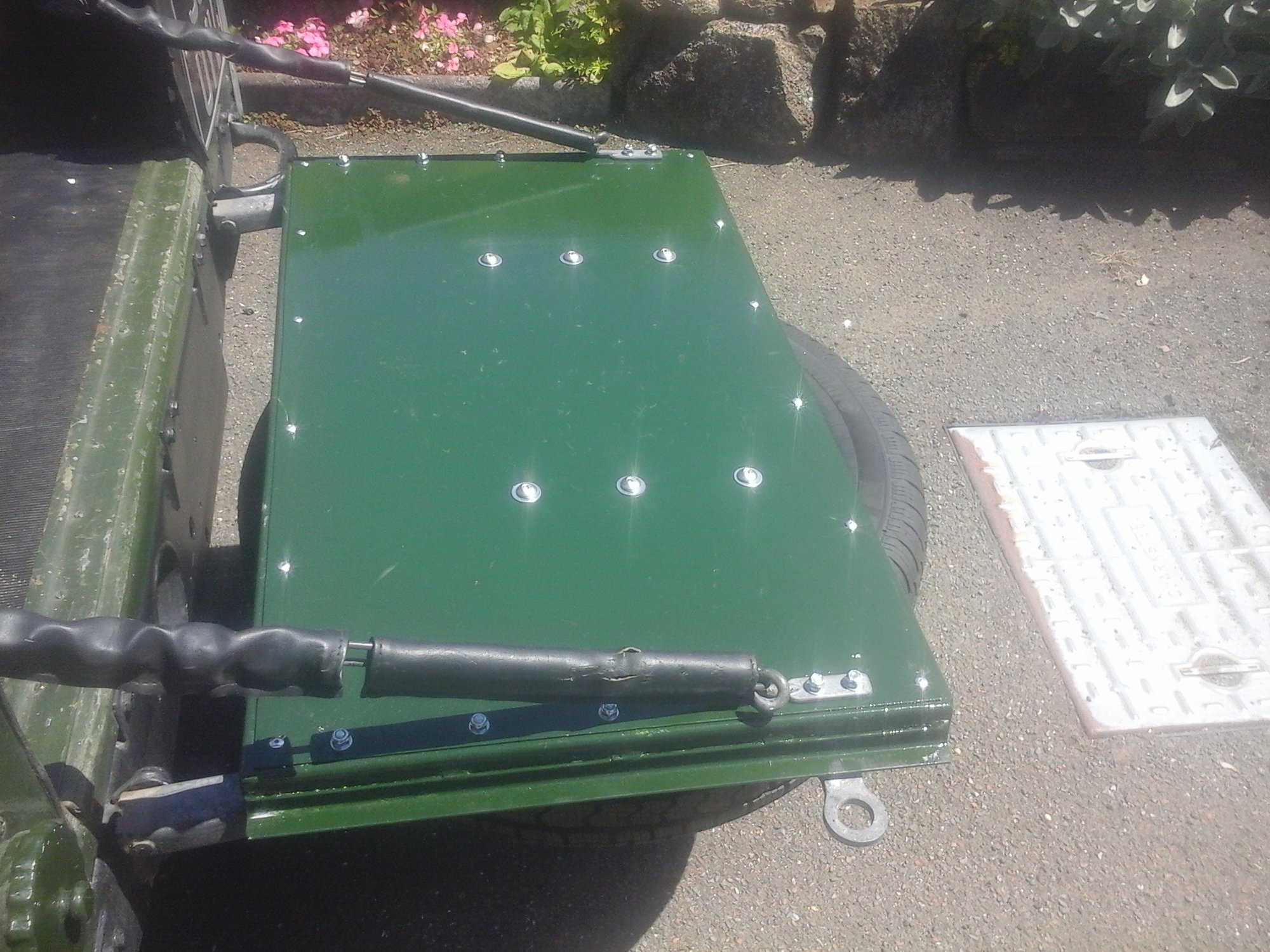

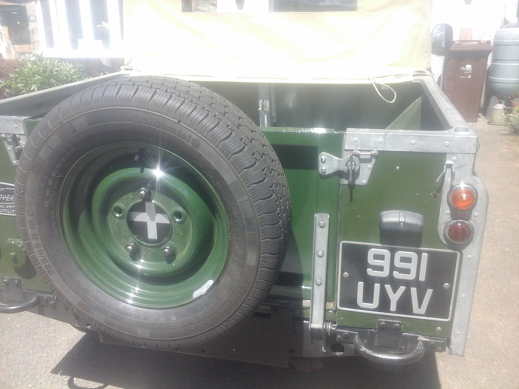

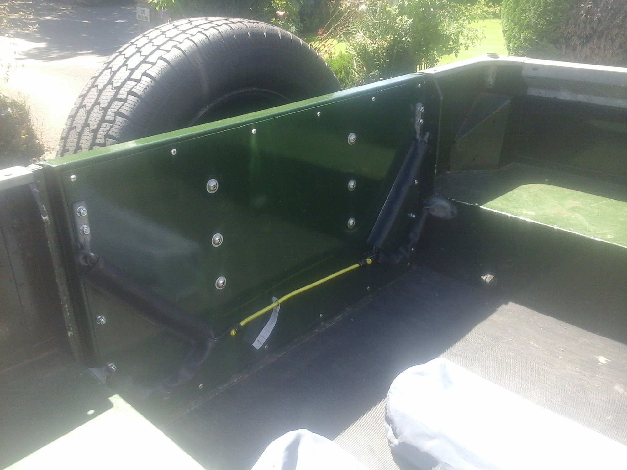

Hi , finished , all steel series landy wheel carrying tailgate , wheel mount from an old disco , 40x40 box , 1.2 ish steel sheet and 20x20 angle for reveals , bungy to keep chains out of the way , good old Aldi inverter welder, roller painted to match rest of car , original fittings used with new bolts , old tailgate stored as is the inboard wheel stowage, all reversible for originality ,
