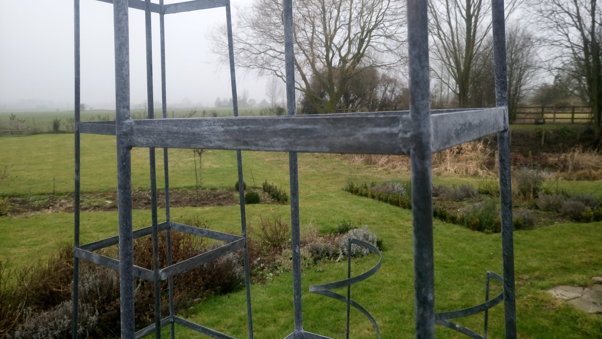

Does anyone know if T wash gives the same visual results on zinc sprayed surfaces as it does on galv surfaces?
So far I haven't applied T wash myself and have only had the galv firm do it. Close up snap attached of a plant support with galv + T wash combo. It's a popular look with customers on garden products and I have something that I want that finish on, but don't trust the heavy handed galvers with.
