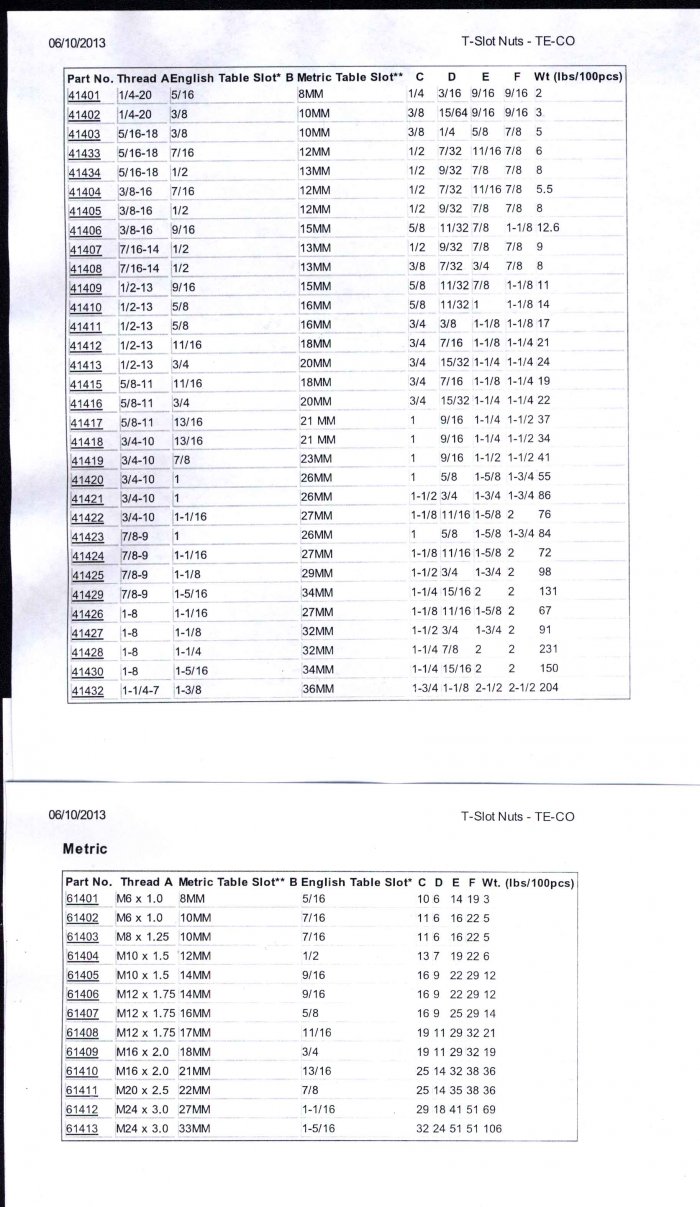

Sorry to delete a reply, I tried to copy and paste a manufacturers spec and it looked like non understandable gibberish-- it should have looked like this.
Stan.
Link:http://www.te-co.com/T+Slot+Nuts-C-PG1045-C-.aspx

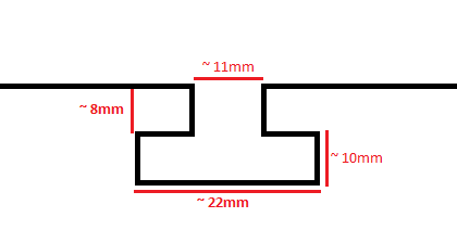

Don't have access to a milling machine tbh, I might buy one of each and see what fits, if the 12mm fits i could take a file to the slot as its not 100% straight so may well be 12mm in places I just measured one end as I was in a rush at the time.
