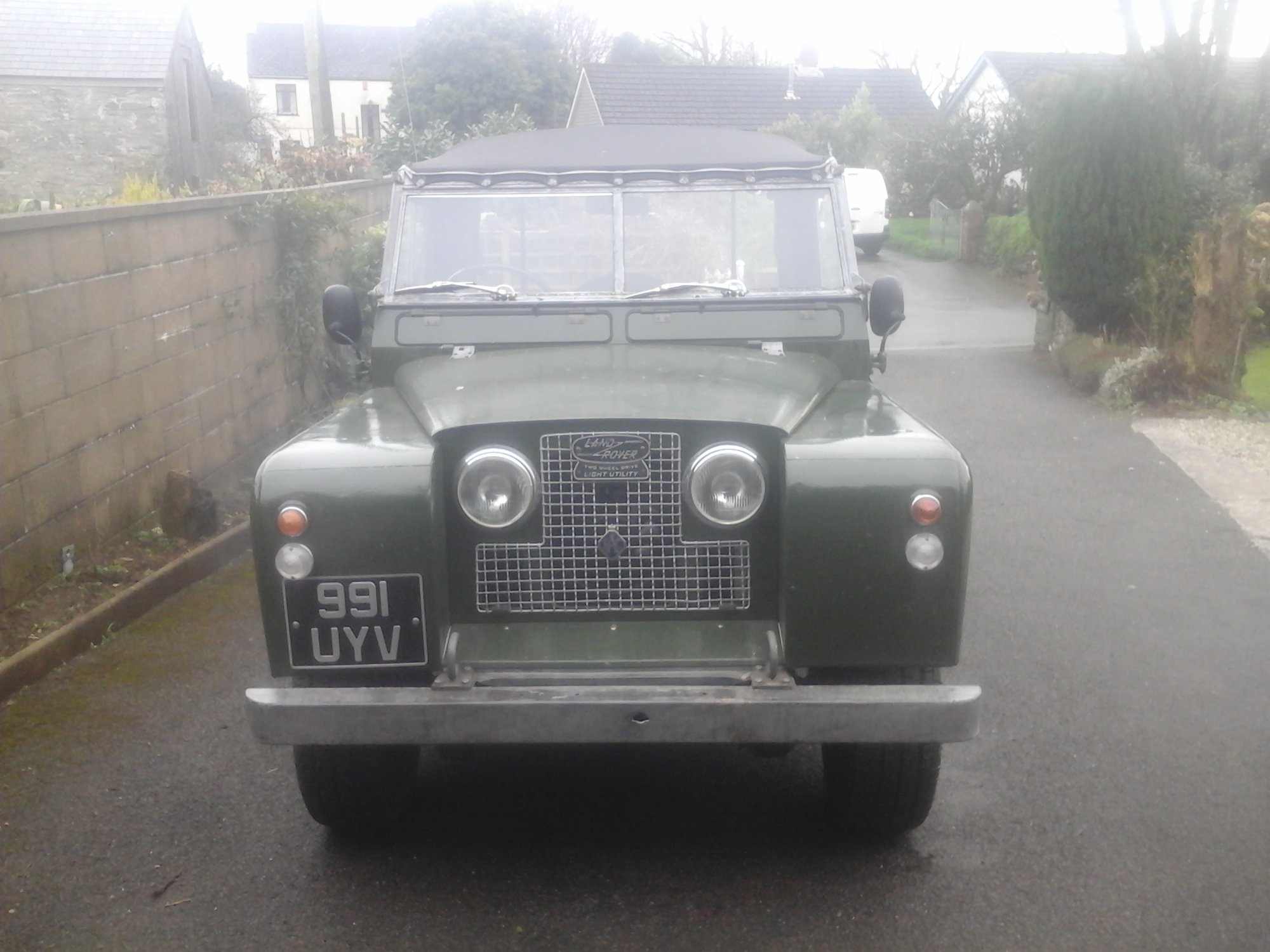

Hi Chaps,
I have a rare S2 4x2 landrover it is mechanically excellent but has suffered from 60 plus years of badly prepared painting , lastly in Tekaloid green code fo3, my question is would cellulose thinners remove the enamel in a fairly gentle way ? I know Ican get synstrip and sanding , the idea is to expose the original finish and then decide on whether or not to repaint , may be pipe dream I know , simply not in a position to have a pro paint job ,
Cheers
Chris

I had to strip my 101 of thirty years worth of REME hand painted camouflage green, I gagged on paint stripper in sections and squidged baco foil onto it to stop it drying out. Its really effective.
