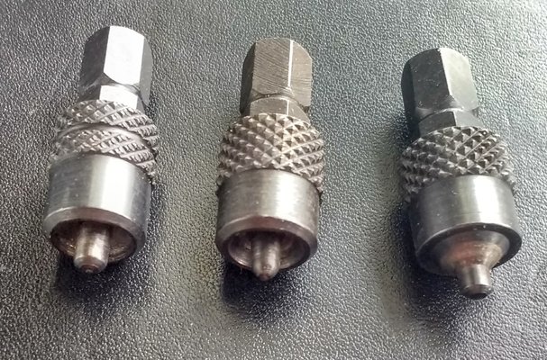

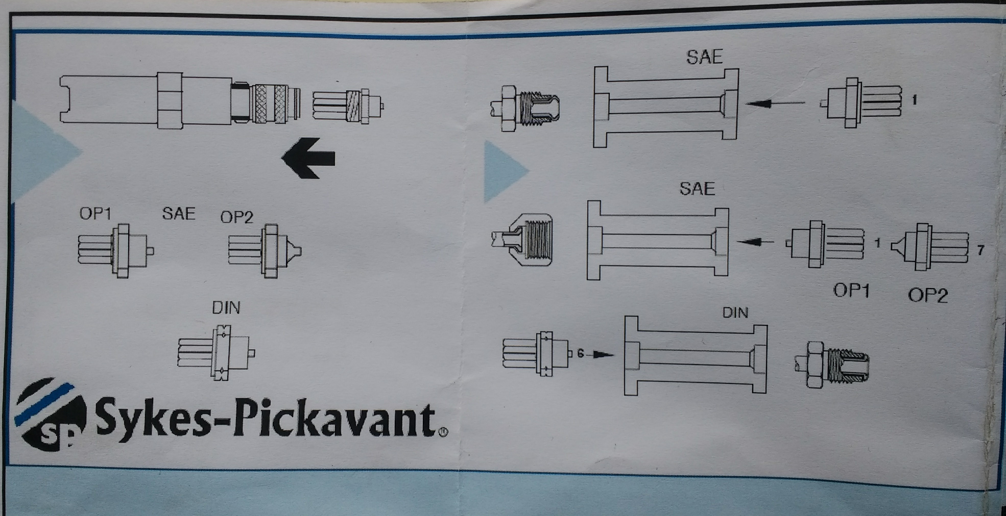

Here is a picture of the full set of punches for the original Flaremaster now that I've received the missing DIN punch from Sykes.
View media item 10380
To identify them the numbers punched into each one are the same as the instructions posted by Sid further up
Left - OP1 SAE bubble flare stamped number 1
Middle - DIN metric flare stamped number 6. It has a grove cut around the hex
Right - OP2 SAE Double flare stamped number 7
Also if you look closely at the form of the DIN punch it has a small shoulder at the start that will produce a small vertical flank before the radius is formed on the front on the DIN flare.
