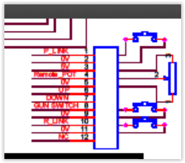

Just bought an SWP Stealth Digi-tig 180DC PFC MV machine, and and SWP Pro series 2 torch to go with it. The torch has a single switch, but you can buy other switches and pots to go in it to control current etc., so there are 6 control wires from the torch. The machine has a 12 pin socket. I know which two wires and which two pins are the switch, but would like to solder the other wires to the correct pins while I'm at it, in case I want to add say a pot later.
SWP responded immediately to my email and told me which two pins are for the switch, but then the guy said he didn't understand when I asked about the other wires, and hasn't replied since.
I just need to know which pins on the socket are for what. Presumably the foot pedal (which I don't have) uses some of them. Anyone got any more details on that?
