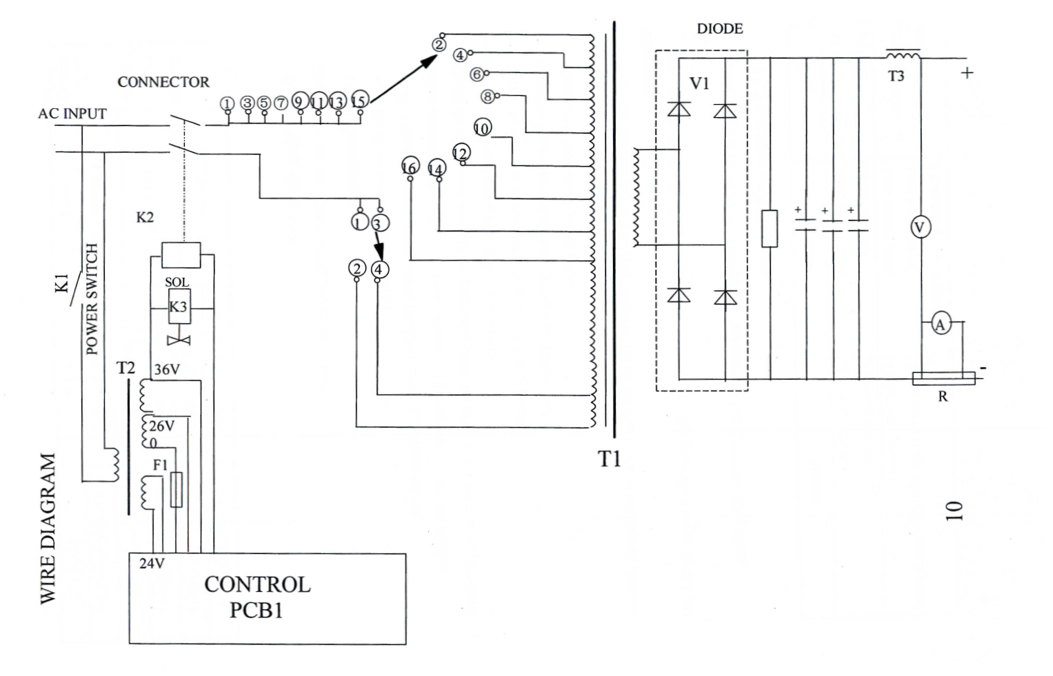

Daveville30 Member Messages 115 Location Ireland Aug 9, 2024 #1 How's it going anyone have any idea what's wrong with my welder on the highest setting 5 and 6 it won't weld works perfectly in 1 to 5. Cheers

E eddie49 Member Messages 4,933 Location Reading, Berkshire Aug 9, 2024 #2 Could be faulty contacts on the rotary power selector switch, or loose terminal screws on links or transformer tapping wires at that switch. Does the switch mechanical action seem different when you step up to those last positions?

J julianthegypsy Member Messages 4,408 Location Cirencester Aug 9, 2024 #3 Most likely the rotary switch.

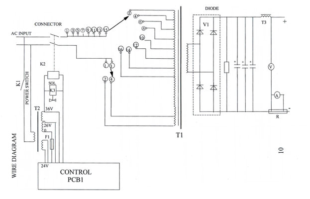

N Nix2 Member Messages 146 Location Poland Aug 9, 2024 #4 If it's a SWP 280/4 then it's a diagram like this, but the switch has 8 positions, not 6... maybe a different machine?
