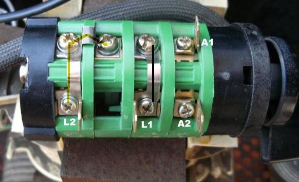

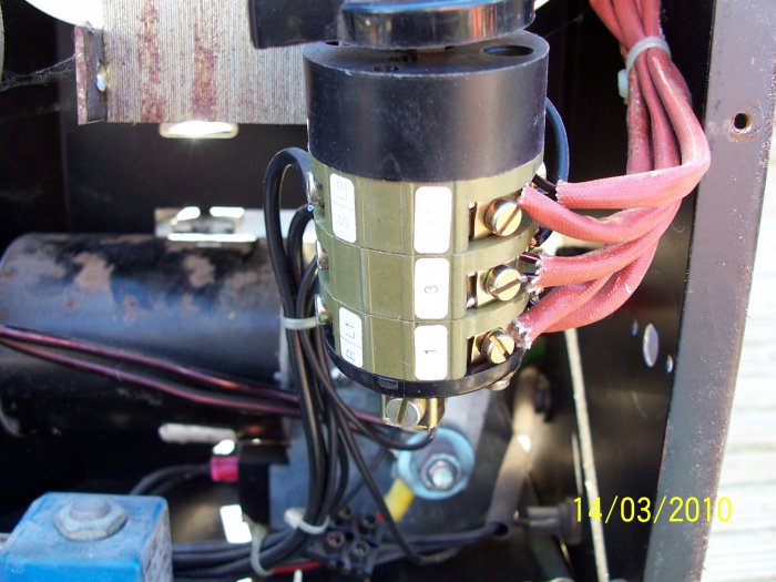

Just a quick sanity check (!!)
When measuring the open circuit voltage of my mig, I am expecting it to increase as the power setting goes up, right?
'Cos if this is the case, having just fitted my new switch (thanks Rosepuds!) the old one was wired really wrong...
Ive double checked this too, and it was wired:
Pos 1: 43.2V 5th highest voltage
Pos 2: 50.6V Highest power (6th)
Pos 3: 37V 4th Highest
Pos 4: 33.7V 3rd Highest
Pos 5: 29.9V Lowest (1st) (Has never worked for me, as the switch was knackered...
Pos 6: 31.6V 2nd Highest
