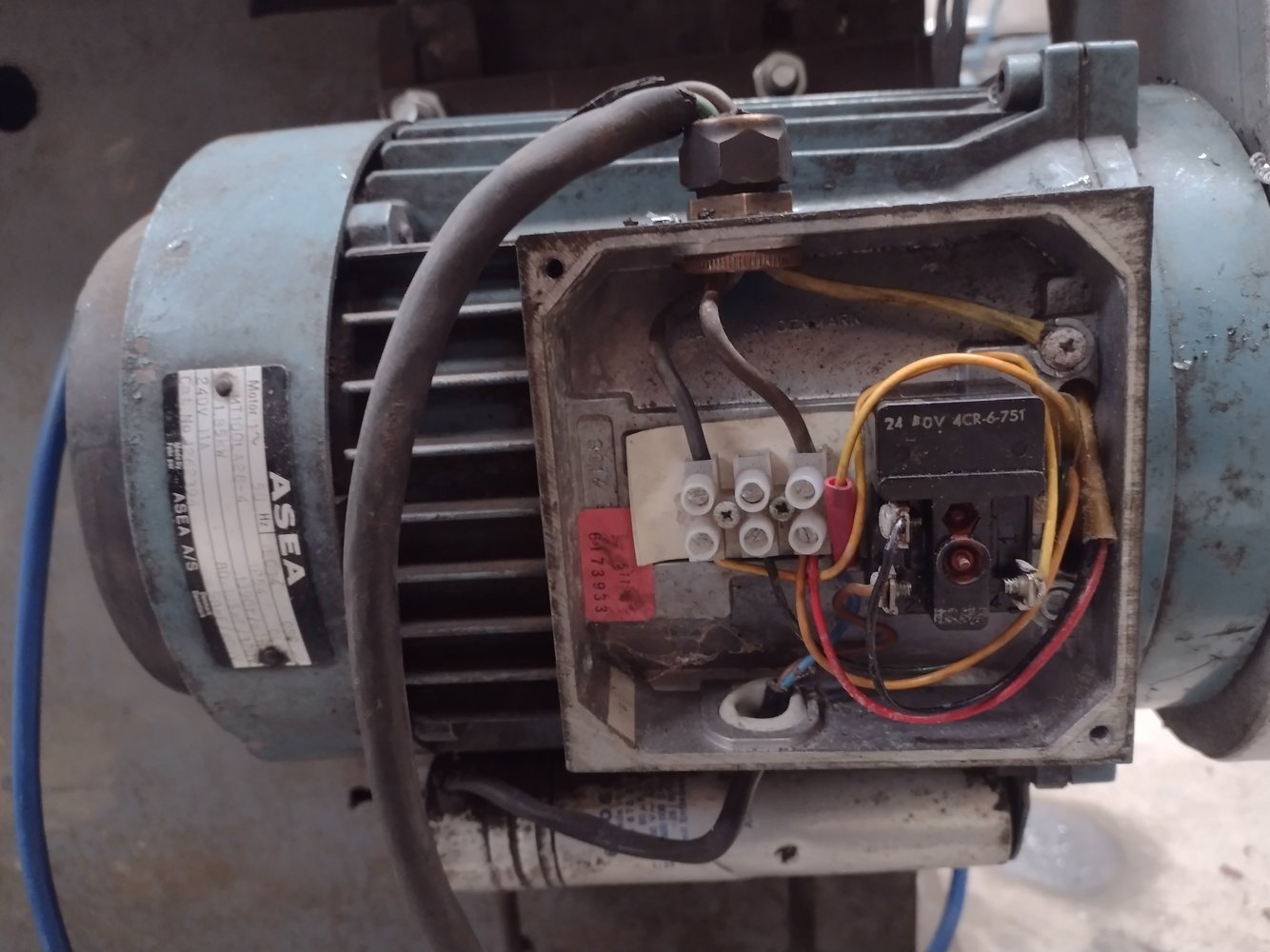

that wont be much good its the starting windings that cook if repeatedly started there only usualy run for a couple of seconds before the centrifugal switch disengages themNothing keeping you from hanging a 4" computer fan on the back of the motor.
dont bank on that if you work on motors. stick a screwdriver across the caps the caps after its stopped for a few mins and there is a good flash. you wouldn't want your fingers in thereAs soon as the motor stops, or even drops below about 75% speed, the cap is shorted through both windings, so that seems unlikely.
On a.c. motors ?dont bank on that if you work on motors. stick a screwdriver across the caps the caps after its stopped for a few mins and there is a good flash. you wouldn't want your fingers in there
Something like an open winding or switch in that case?dont bank on that if you work on motors. stick a screwdriver across the caps the caps after its stopped for a few mins and there is a good flash. you wouldn't want your fingers in there
