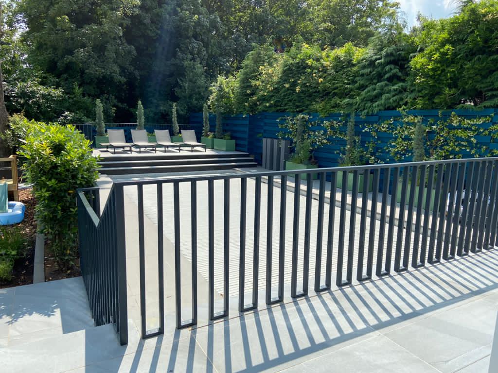

danbrown89 Member Messages 222 Location Watford May 11, 2022 #1 316 grade stainless steel rectangular frames made from 50x25mm RHS. Each frame has 2no M6 studs resin fixed through the porcelain slabs. Top capping acts as a handrail and keeps them all in line. Power coated 7016
