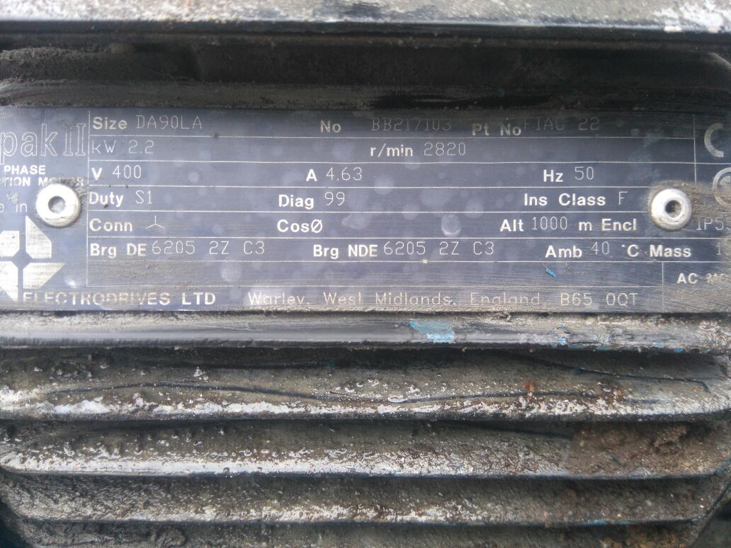

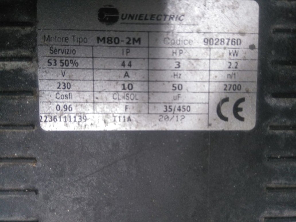

Hi new member here
Just bought a 3 phase compressor a few weeks back and swapped it to a single phase motor, when the compressor hits 50 psi but motor is bogging down and tripping the little cut out switch on the motor. Both the 3 phase and single phase motor are the same 2.2kw and 2800 rpm, i ran the 240v motor on another compressor with no problems at all.
I've found a slight leak in the un loader valve when its building pressure, would this cause the motor to start bogging down? I don't know output of the pump but its no more than 18CFM. Are these 2 motors roughly the same? or is the 240v under powered?
I was going to order a 4hp motor and 4" pulley but i thought i would ask before forking out nearly £200.
Any help would be appreciated guys
