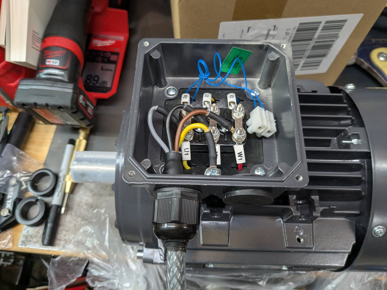

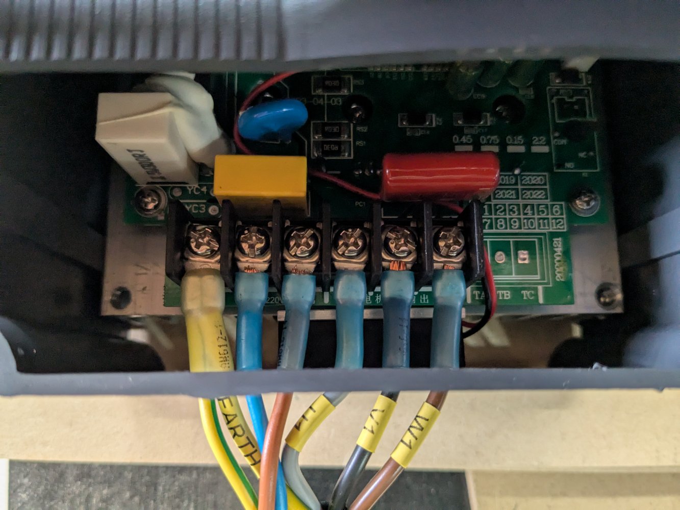

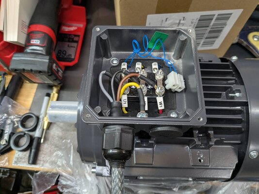

Finally, I've added a couple of photos just to sense check the wiring as it's my first venture into VFDs. I saw in another thread that the thin blue wires are for temperature sensing, presumably it's ok to just leave this as it came capped off in the connector block? Don't think my cheapo VFD has an input for monitoring it.
And at the VFD end, I've tied the two earths together as shown - and checked for continuity from various points on the motor housing through to the earth pin of the plug I've wired to the VFD input.
Thanks in advance for any comments/suggestions!
