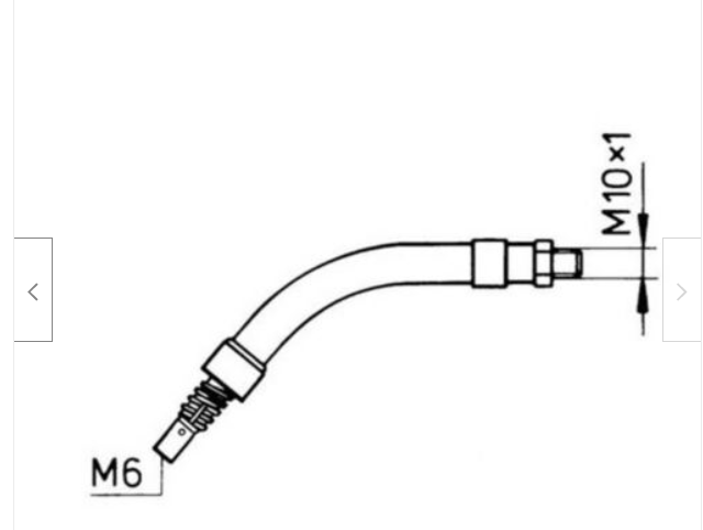

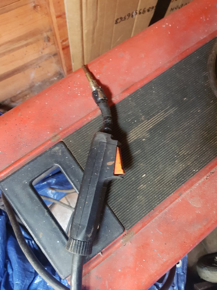

Could be - ask any Moto Guzzi owner...Trafimet (Italian) so it's unlikely to be an imperial thread.
Could be - ask any Moto Guzzi owner![]()

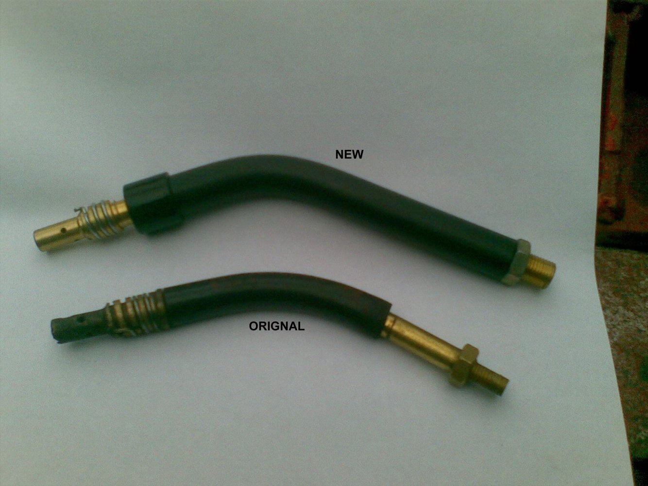

How did you bring it down from M10 to M8? I can get a M8x1 die but not sure how to file it down to 8.5 or 9mm for the new die. ThanksThat will be a M8 x1 thread. I did the same sometime ago. Bought a new swaneck from MM and found the thread was M10. I have a die box (as used on machines) and was able to slowly recut the thread from M10 to M8View attachment 293768.View attachment 293769View attachment 293770
Was looking for an adapter but could not find it. Need to be M8 male to M10 femaleA machine die box has a large range of adjustment unlike a split die.
You might be able to find an M10 to M8 adapter (ebay?) https://www.ebay.co.uk/itm/254347058343?hash=item3b38441ca7:g:43QAAOSw3o1da56Z
But not from Germany due to shipping !
Perfect. Many ThanksMy bad ! was thinking of to many females....

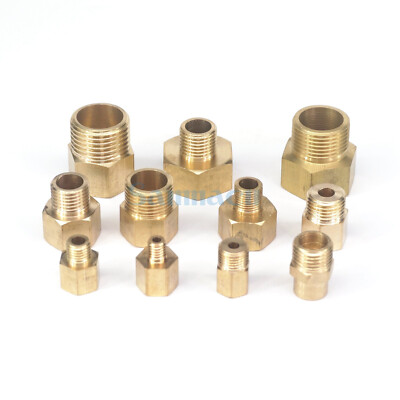

2pcs 1/8"-3/4" BSP M10-M27 Female to Male Brass Reducer Reducing Fitting Gauge | eBay
LOT 2 BSP Female to Male Brass reducer Reducing Fitting Bush for Pressure gauge. We will be happy to resolve any issues you may have in a cordial and friendly manner. All products are quality checked.www.ebay.co.uk
