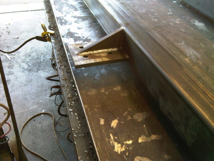

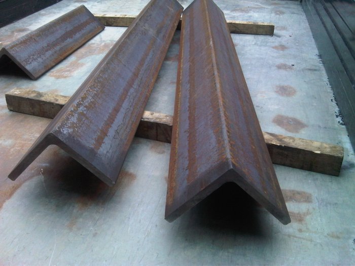

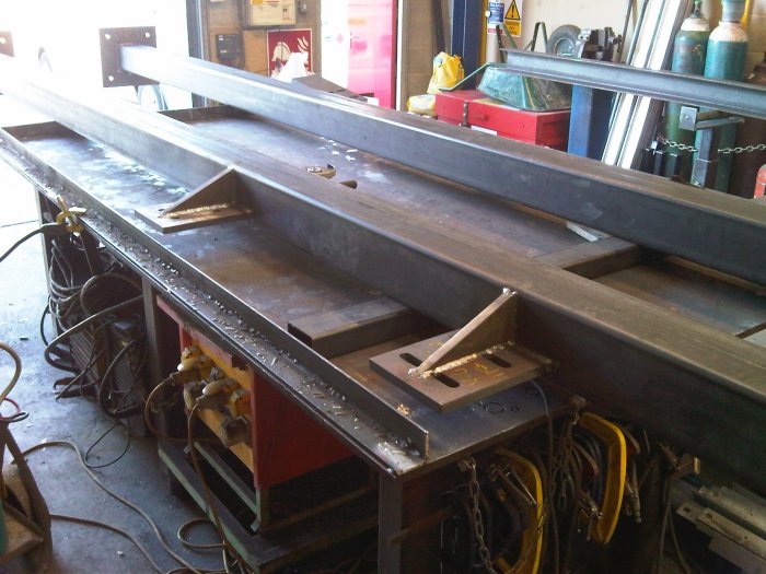

Last nights little job. Profiled plates, 150mm box section columns, 200x200x20 angle
Support for a cantilevered floor. Finish it starting at 5.00am tomorrow, at the galvanisers for 7, fit yesterday!
Design for the slots is rubbish. The welds to the stiffeners clash with them.
