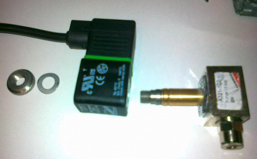

Note as yours is supplied with 24vAC from the aux transformer you will need a valve rated for AC. Some are rated for both AC and DC but may have different values of voltage for the AC compared to the DC so might say 24v AC/12vDC. So bare in mind when sourcing.
