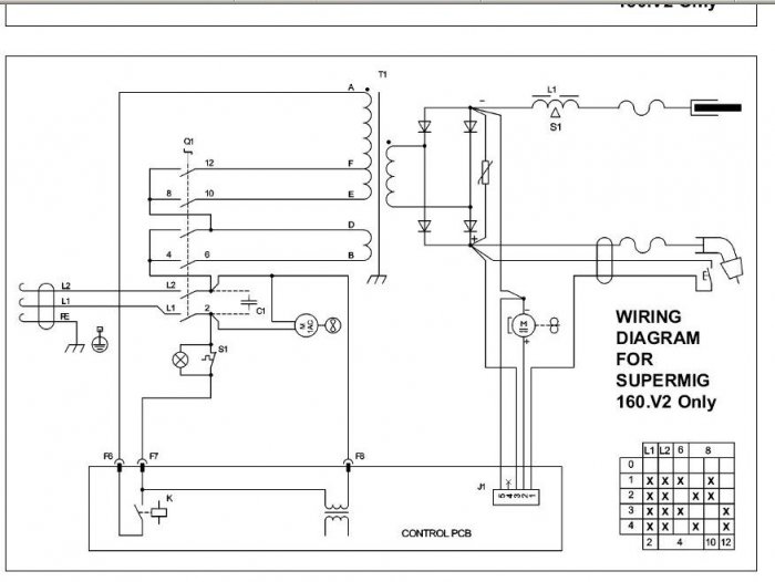

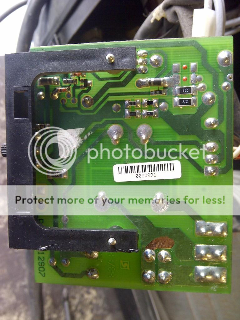

so i was out doing a job today and the wire feed packed up, i managed to get around the issue using a twig and some electrical tape (i kid thee not) however it left me with a permenantly live torch (i know i know!)
Now back at home i've had a good look over it and it seems as if the relay that supplies the wire feed motor is not getting any voltage to make it click how ever if i switch it using an external power source it works fine, i dont mind having a poke about with a multimeter but would like some help with what to look for/find
I have gone through all the wires found where they go and checked for continuity and all seem fine.
