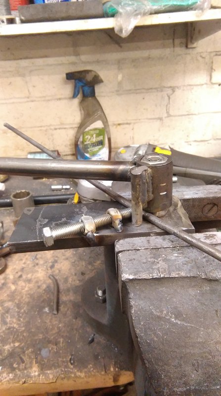

mtt.tr Member Messages 8,461 Location Essex/Suffolk border Oct 2, 2015 #1 I'm using more and more 6mm rod for decorative items you can make some brilliant things with some imagination. Anyhow I need a cheap dirty former so quick rummage in the junk bin half hours welding and grinding jobs done. IMAG0216.jpg 65.3 KB · Views: 116

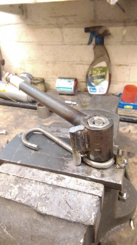

mtt.tr Member Messages 8,461 Location Essex/Suffolk border Oct 2, 2015 #2 Here is the start to an external lamp IMAG0217.jpg 74.2 KB · Views: 77

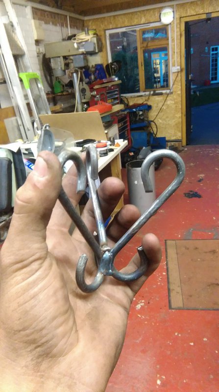

mtt.tr Member Messages 8,461 Location Essex/Suffolk border Oct 2, 2015 #3 Since improved. IMAG0219.jpg 74.7 KB · Views: 96
P paulmitchell1984 Member Messages 832 Location Leeds Oct 2, 2015 #4 quite like that idea may rob it what does the bolt do just hold piece in place? im fairly new to this

mtt.tr Member Messages 8,461 Location Essex/Suffolk border Oct 2, 2015 #5 Yeah bolt just holds the rod means you don't need much left on the length as it cant roll off.
