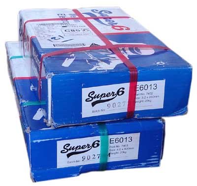

I'm only a hobby welder so I know nothing compared to you guys but something I have found with Super 6 6013s (mainly 2.4mm) is that they run much nicer and more consistently with pulse. For 2.4mm I set my R-Tech tig ac welder to a base of 60 amps and peak of 115 amps and pulse width in the 12 o'clock on the dial (guess this is around 50/50). TBH I didn't know this welder could do pulse stick (I thought it was only for TIG) but since discovering that it does I now use pulse stick all the time. Have just ordered some Super 6 7018s from Langley Steelworks so am looking forward to giving them a try.
