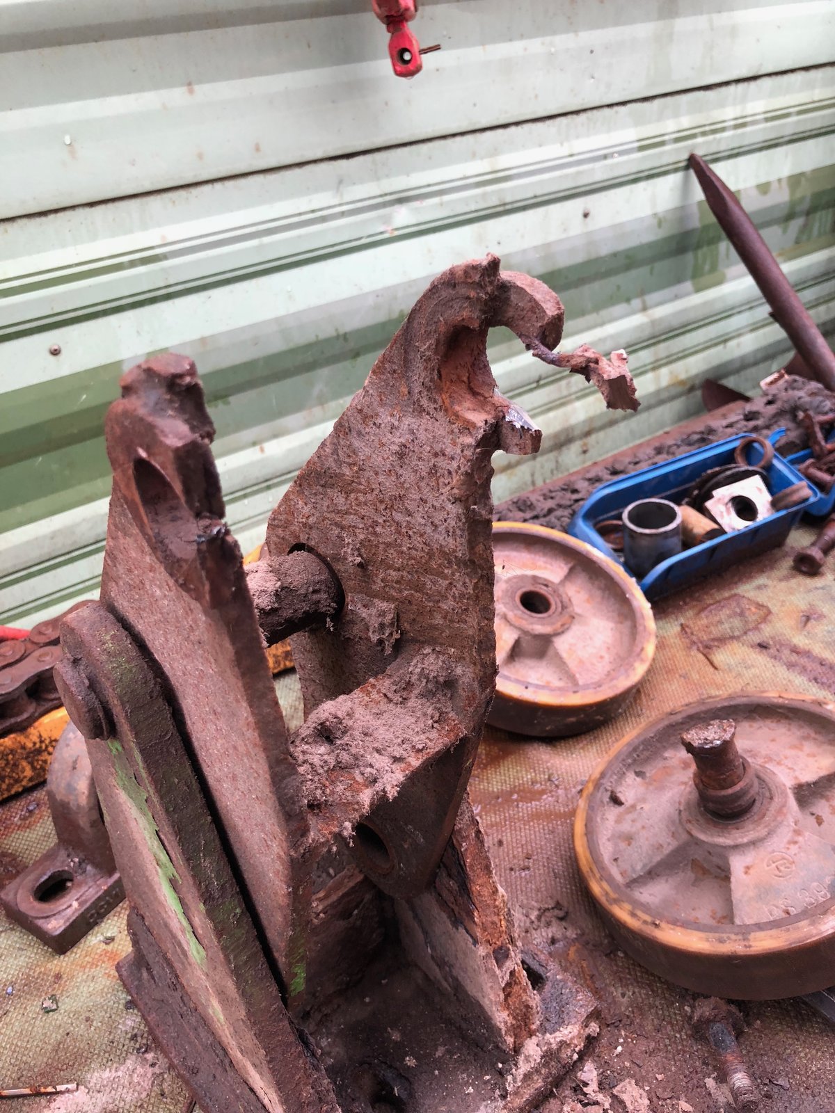

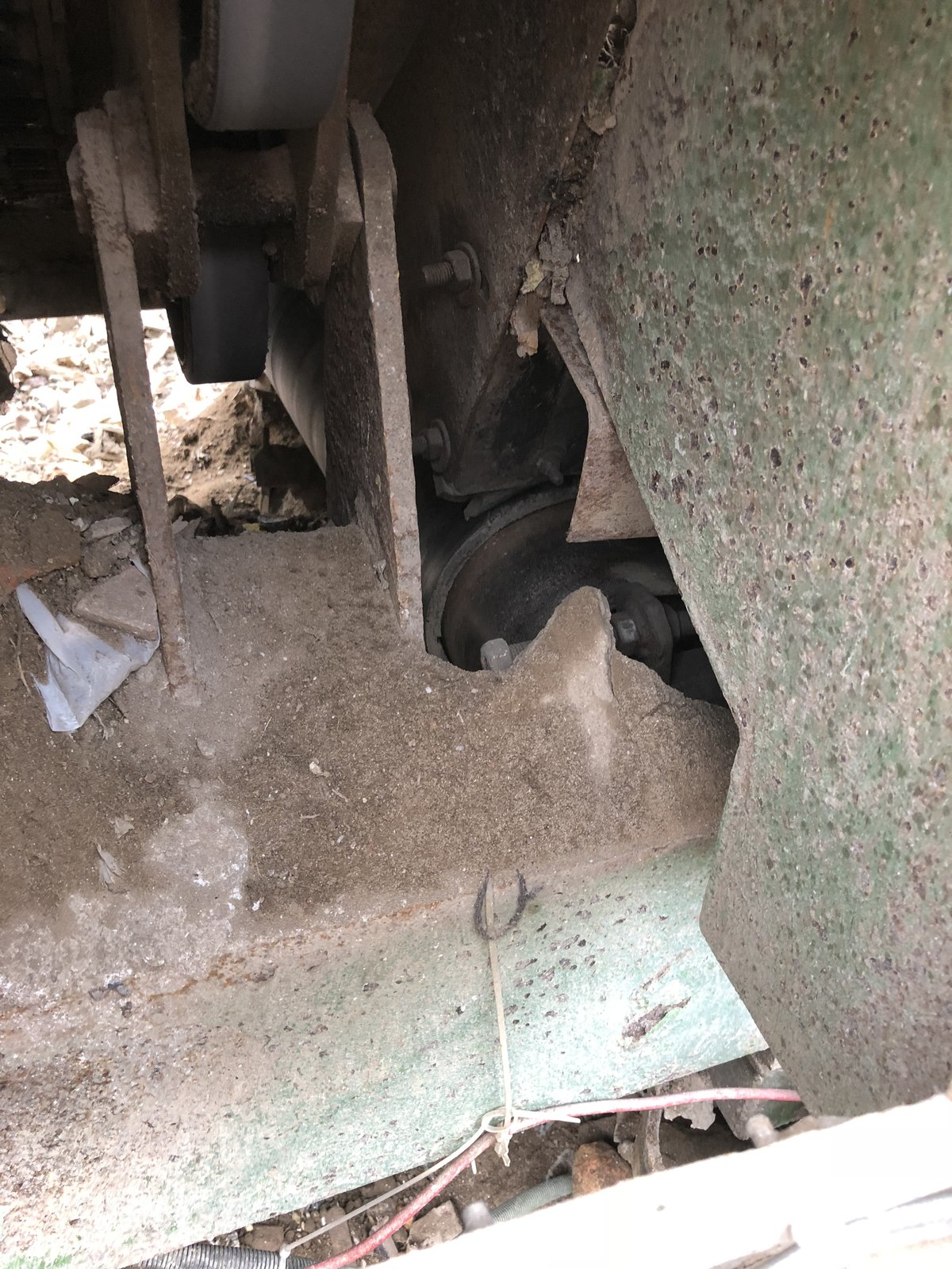

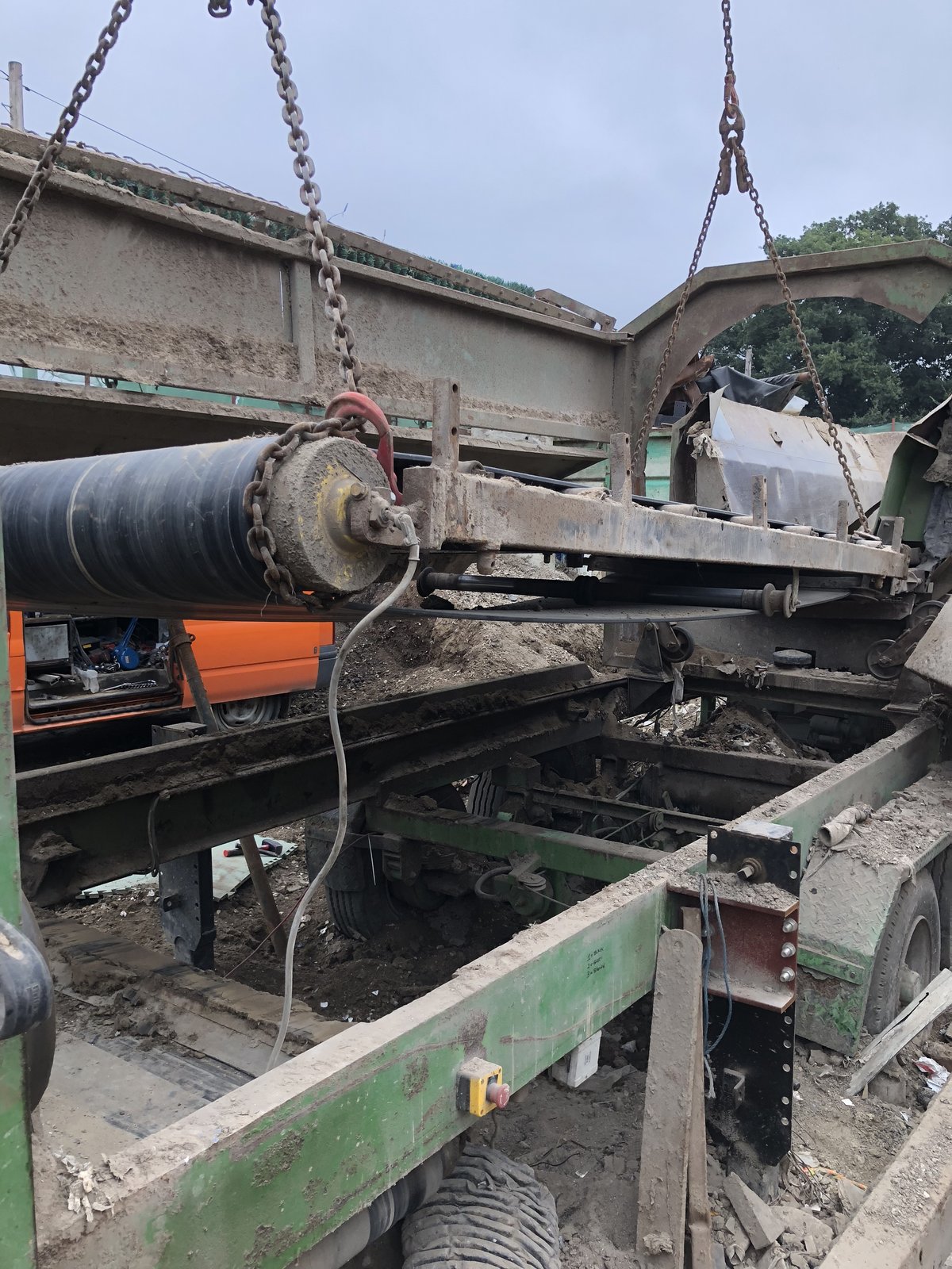

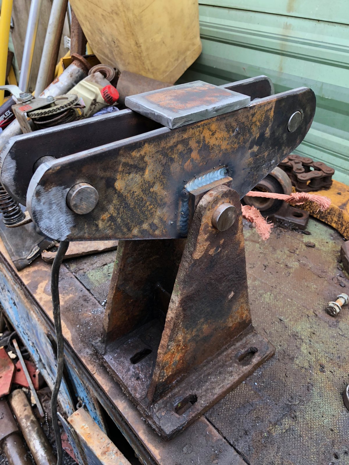

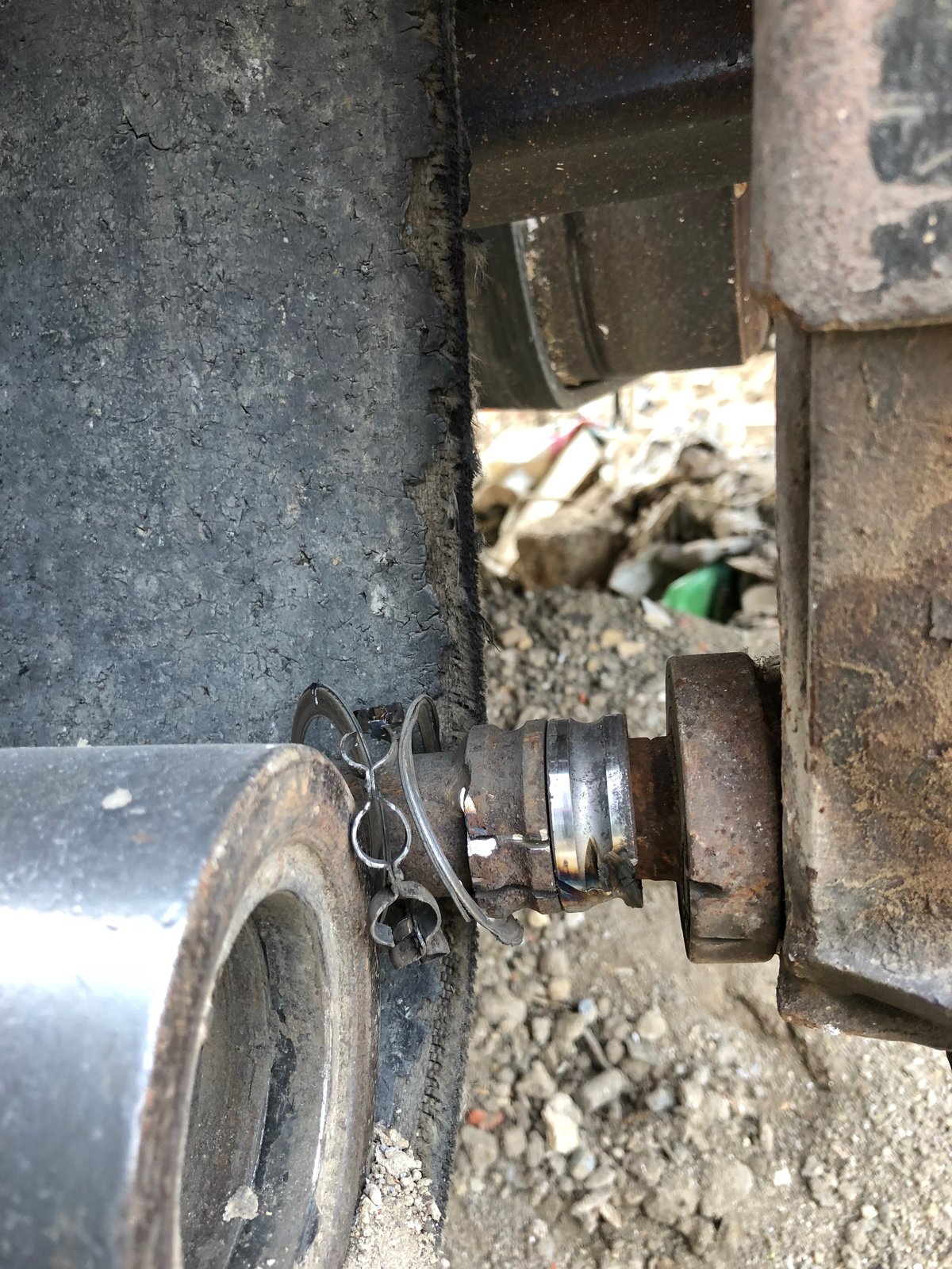

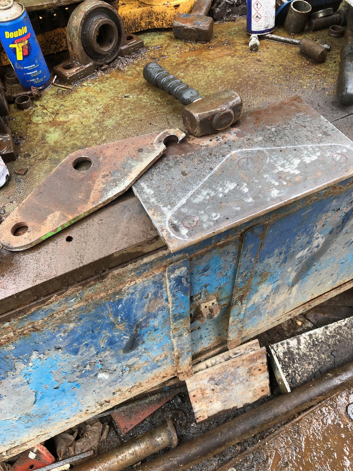

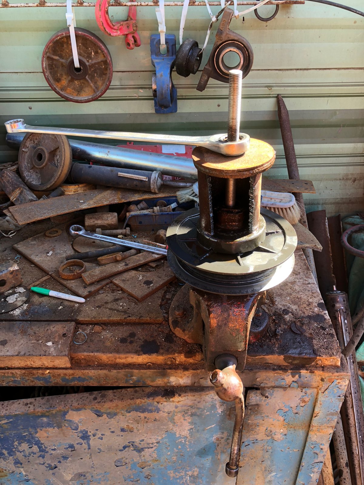

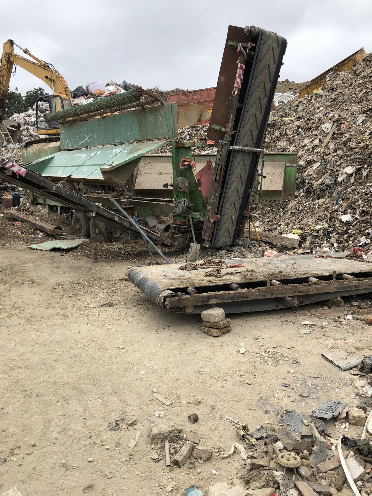

hi guys, I thought I would post up one of the “ongoing” jobs I have at the moment. This is a German Tromell from around 1995. The poor old thing is tired out but for some reason they keep asking for it to be resuscitated. When it turned up it screeched like a banshee due to the screening drum bearings being shot to bits. It has an air cooled Hatz Deutz engine coupled up to a large genny which runs the tromell on 3 phase elektrickery. The main lower conveyor chewed the bearings up in the idler roller so to get access to it you need to take the thing apart. The bearing housing looks to be chewed up and the adjustable slides have been welded in instead of bolted so a job for the plasma cutter in a bit.
