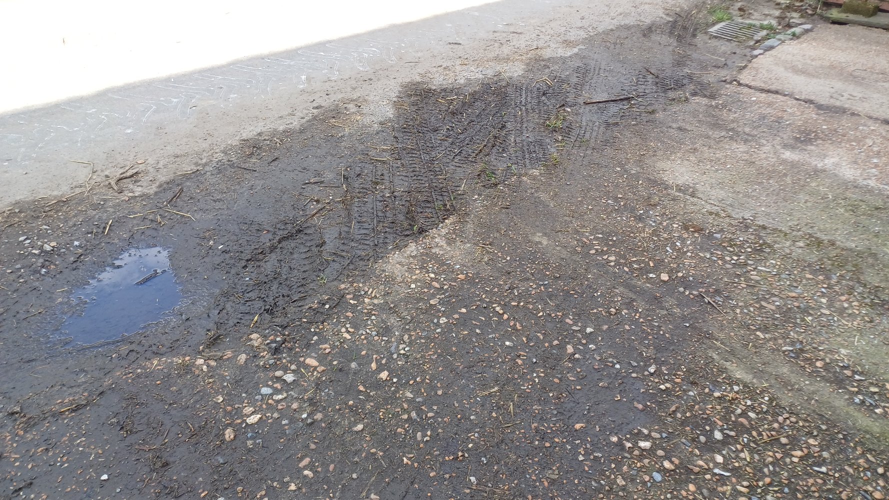

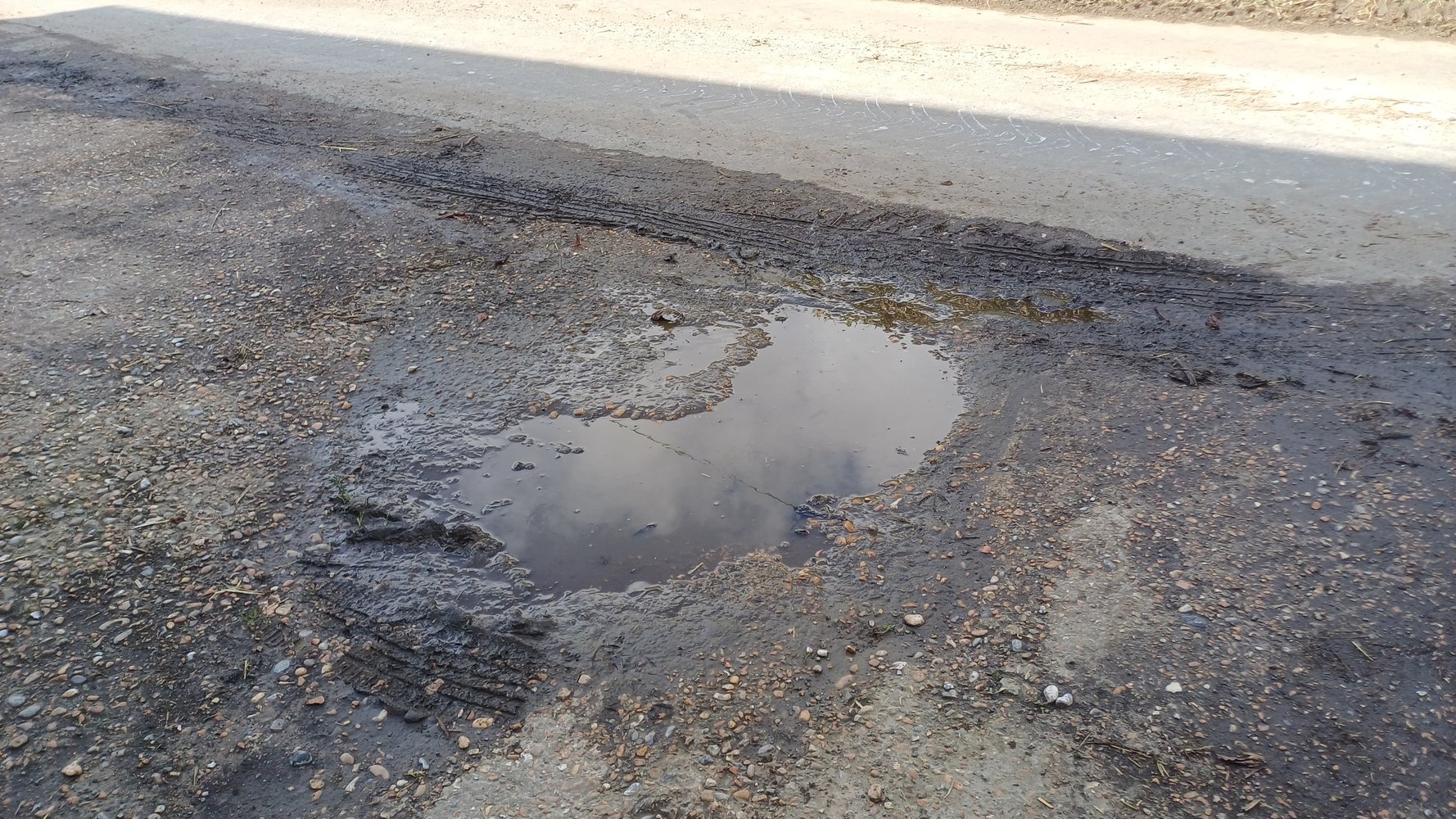

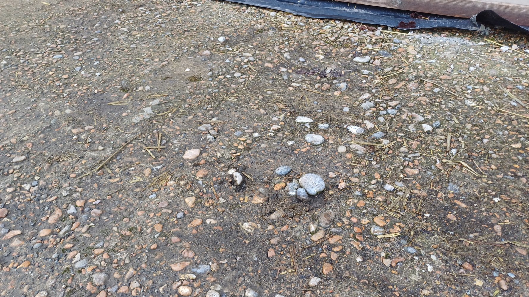

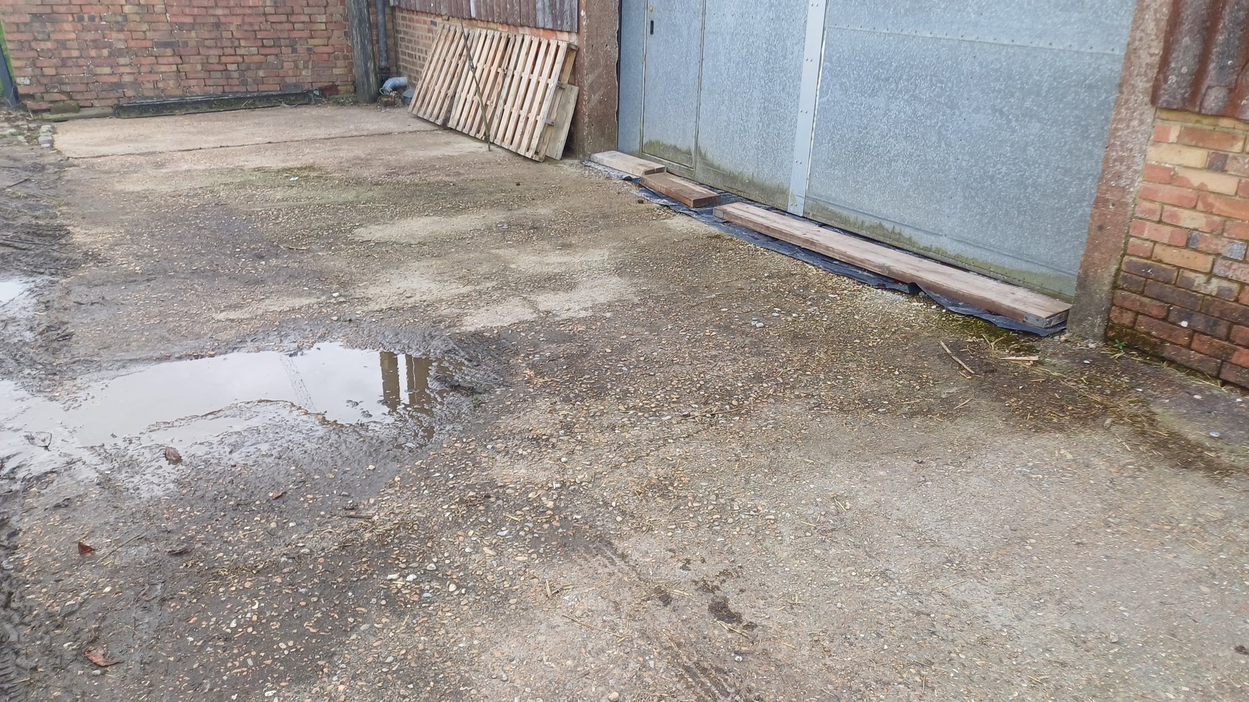

Ordinary 2WD counterbalance fork trucks will cope with a bit of uneven concrete or hardstanding no problem. Only thing is of course the need to keep the load low as much as possible due to the pitching even a small lump causes a solid-wheel truck to do (ratchet strapping steel to forks is a good idea unless the ground is very good & level - it doesn't take much to get heavy steel skating off fast).
