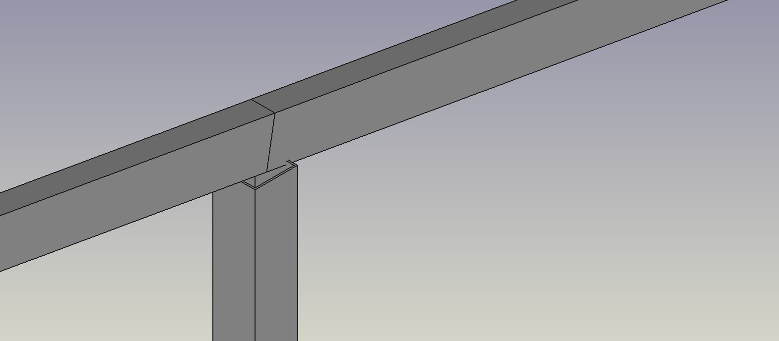

What would be the suggested method of making this weld connection, that is to weld the 50mm edge of the RHS to the top end open end of the 90mm SHS ? Is it best to weld a section of plate/flat bar on the end of the 90mm SHS and than fillet weld the rafter on top of that or what are the other options?
