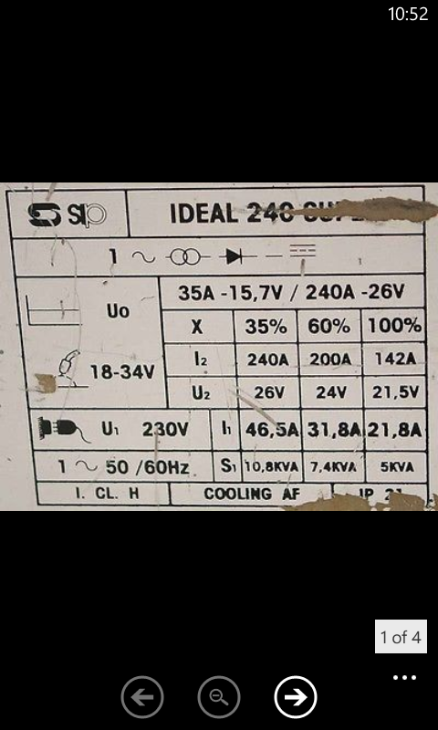

First off, SIP Ideal 240N.
Seller has pictured it with a 5pin, 3ph, 32a plug, but the data plate reads 230v. Am I just being completely stupid, overthinking it, and the welder is actually single phase, not three as the seller states?
It'll want a huge supply but that's fine..
Picture attached.
Second, a Murex 210-1.
Been in contact with the seller as its advertised as Spares/Repairs. It'll weld ok on the lower settings, then blow the fuse in the plug. To me this makes out its on a 13a plug which could indicate why it blows the fuse on the higher settings, but...
Any known issues, or reasons why a welder would constantly blow fuses?
